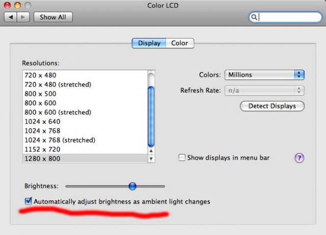

I think I found your problem, there is an ambient light sensor that automatically changes the screen brightness to help alleviate eye strain.
If the room where your MBP is not very well lit, the amount of light from your screen while displaying a mostly white or light background will cause the sensor to think your screen is to bright and adjust it.
When the screen or background is mostly black or dark the sensor will think it needs to be adjusted again.
There is a setting in System Preferences to change this behavior under the Display settings

  Damian. said:
You can turn off Auto brightness in: System preferences > Displays
Um yea thats the setting ive been talking about
:yes: That should solve your problem. It's a feature of the MacBook Pro line, but in a poorly lit room, your screen is really the only light source it has to go off of.
