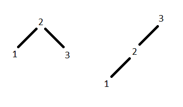

I have been trying to figure out a way to compare two Binary Search Trees without multi-threading or any other such parallel computing means. The goal is to test the equivalence of two Binary Search Trees.
The definition of equivalence here is that the number of nodes must be same, and values contained in the two trees must be equal.
For example, see the attached image for two equivalent trees. Now, how would you test the equivalence of these programmatically?
One method I know of is to traverse the tree using any of the traversal methods - Inorder, Preorder, Postorder, etc. and then compare the results with the other tree's. One may even use a BFS or DFS algorithm.
Any other more efficient ways you can think of doing this?

it seems that what you really want to know is if they both contain the same nodes since the tree structure can be slightly different and still be balanced.
if you have or can keep a node count in your object that is updated as you add and remove nodes, you could use this as your first check to see if the trees are not equal. if both trees dont have the same number of nodes then you know they're not the same search trees. but having the same node count doesnt mean they are equal, so you can only use node counts to more quickly determine that they're not equal.
the next step if they do have an equal node count would be to traverse one tree and search for that node in the second tree. this should be fairly efficient since you're using search trees. the tree that's traversed would have each node touched once, and the tree being searched is s tree used for searching! at any time in this process if you cant find a node from tree A in tree B you can short circuit the comparison because you know the trees are not equal.
the worst case for this method is when the trees are equal since every node in tree A will have been searched and found in tree B and none of the short circuits would have occurred.
there may be other ways of doing this but this is the first way that popped into my head and it seems pretty good.

function structeq (t1, t2 : tree) : boolean;
begin
  if t1 = nil										then structeq := t2 = nil
  else if t2 = nil								 then structeq := false
  else if structeq(t1^.left, t2^.left)   then structeq := structeq(t1^.right, t2^.right)
  else												structeq := false
end
That's not my code. But it checks if two tree's have the same structure. To check the values as well you probably need to use "AND" t1.value = t2.value. Probably better to use it with C though, the short-circuited && will come in handy when you want to check the value only if the pointer is not null. (Pascal would require nested if's which is just biah). It's basically what you said, written in Pascal in a neat way.
You can't go any faster than that as far as I know.
begin
end
Cool! That way you can check if the two trees are identical in terms of value and structure together in O(N) time. It looks like a Preorder lockstep traversal. Good one!
