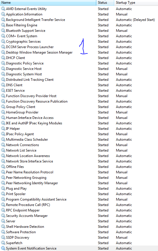

How about the dependencies? The audio system relies on a few, were you messing around with the services disabling stuff? Windows Audio, Multimedia Class Scheduler, and Windows Audio Endpoint Builder should all be on automatic. They also rely on PnP and RPC, but if you've got those disabled you're probably experiencing bigger issues than no audio. You should also have a running task under the Task Scheduler, SystemSound under Multimedia.
Yea, not only isn't it active, its not even registered anymore.. Multimedia Class Scheduler is a dependency and it's gone. (Image #2)

Noticing that you're missing Remote Procedure Call and Plug and Play as well.. RPC is a rather vital service for Windows to even run. Aside from disabling stuff, did you run some sort of "tweaker" that actually removed services?

Completely disregard what I said above, didn't notice the sorting that you had on the services.. they're not missing, just a brain fart on my end. (Serves me right trying to think before I've had my coffee.)
Hit your event log, it should tell you why the audio service isn't starting. Is the Windows Audio Endpoint Builder service able to start? (Force it from the services control, see what happens, if not, check the log to see why it's not.)
