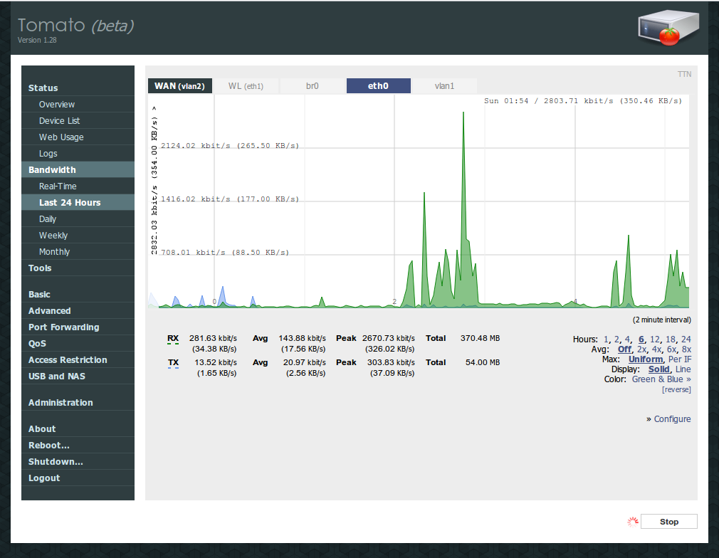

Using tomato on my Netgear WNR3500L N router.
Loving it, and far superior to the stock firmware in features and stability.
Is that a custom skin? It looks great.
I'm on version 1.28 (the usb mod version) and the web ui just looks the same as always:
