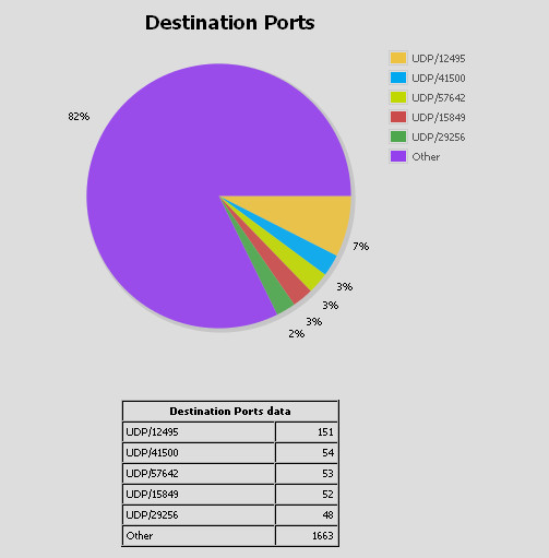

Here is sample of destination ports my firewall is seeing on my home box
Where your problem is if your letting mssql even be talked to by anything other than your webserver -- Not sure exactly what your doing, but databases used for the backend of a website do not need to be open to the public net.. Only connections from itself (webserver) should be allowed.
BTW log only runs for like 24 hours and then is recycled. That graph is
This is a firewall log summary, of the last 2021 lines of the firewall log (Max 5000).
