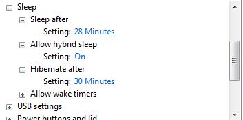

Yes it will. My windows7 box wakes up every morning at 6:50 am from hibernation via a scheduled task, with the 'Wake the computer to run this task' enabled.
Sure you're not using a hybrid sleep? That would work of course as there's still a little power. Hibernation completely kills power. Hybrid sleep writes data to the hibernation file then goes into low power mode, which can be woken up by various events. True hibernation dumps memory to disk then completely powers down, would be like asking the task scheduler to turn on a computer cold.
Pretty sure it's hibernating because the only way it will resume is by pressing the power button, or of course letting it wake at my scheduled task time. As you can see in my attached image it will sleep first then it goes into hibernation and powers down. In fact while in sleep mode the power button flashes every 1-2 seconds until it hibernates then everything is off. (Gateway desktop)
I did have a problem getting XP to resume from hibernation via a scheduled task and was never able to do so until I
found Shutter.exe . It will wake a hibernating XP, and i mean hibernating not standby. (Sony laptop)
