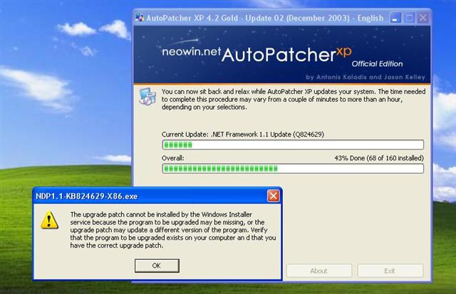

I tested this three seperate occasions on clean SP-1 installations.
It's the only error I am getting, so I thought it deserved it's own thread.
(copied from MD351's post)

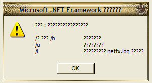

"...but i found a bug regarding the .NET Patch well 2 seperate errors but refers to the same thing.
1)
Some wierd error that only says ???? looks like something todo with the switches because it has /? /h /u /I
in the msg.
2)
I get an error while installing the patch for .NET, didnt happen in the last release....
"The Upgrade patch cannot be installed by the Windows Installer service because the program to be upgraded maybe missing, or the upgrade patch may update a different version of the program. Verify that the program to be upgraded exists on your computer and that you have correct patch."
this error displays on the NDP1.1-KB824629-x86.exe"
BTW I don't get the second error message when the .NET Framework "update" is left unchecked.
https://www.neowin.net/forum/topic/124274-bug-reports-for-autopatcher-42/
Hmmm... we're looking into this, so far none of us have been able to duplicate it. How are you installing it? From CD? From Hard Drive? From Network? If possible, can I get a screenshot of the error?
EDIT - Here's something that looks like your issue, but it's for Server 2003... check it out... very odd: Q821156 - INFO: ASP.NET 1.1 June 2003 Hotfix Rollup Package

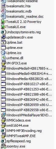

Getting this error when installing Decemeber release of AP.
Looks as if that file isn't even in that folder.. i had just installed that file this week, maybe an update needs to grab files form the installer or something. I wonder if putting hte DVDpack.msi in that folder will take are of the problem.
Well actually the file is there, it's just named something different (WindowsXPMediaPlayer9DVDPack.msi)... you could try renaming it and see what happens...

In the APC file it refers to "WindowsXPMediaPlayer9DVDPack.msi" but that file isn't in that directory. In fact there's nothing with DVD in that directory for me. Same with "WM9Codecs.exe" and "WMP9-MP3Encoding.reg" :blink:
Dazzla, are you saying that under AutoPatcher XP\ProgFiles you don't have WindowsXPMediaPlayer9DVDPack.msi, WM9Codecs.exe, or WMP9-MP3Encoding.reg?

Hmmm... wait... may be onto something here... do you know for sure, if that release of the .Net framework doesn't need the patch? If so, that would totally explain the error.... hmmm....
checked december update files before applying updated and noticed it had
WindowsXPMediaPlayer9DVDPack.msi , WM9Codecs.exe , WMP9-MP3Encoding.reg , WMP9TweakMP.EXE
so i ran Updater.exe to pointed it to AutoPatcher_XP.exe
updated successfully but now i dont see WindowsXPMediaPlayer9DVDPack.msi , WM9Codecs.exe , WMP9-MP3Encoding.reg , WMP9TweakMP.EXE
could be other files missing..
odd.. any md5 on program files to see what else might be missing?

Hmmm... the updater should transfer them over to "AutoPatcher XP\ProgFiles"... I've had no issues, but apparently it's possible for the Updater to miss it. Try running it again. As far as the MD5, I'll try to get you one here soon. :)
tried it for 3rd time. same thing..
checked to compared extracted december updated files to those that folder with successfully applied december updated and noticed

all missing
guess is stops at startupcpl.ink somehow

@blue baby boo - Let me check it... take me through the steps of you updating... is it from one place on your HDD to another? And it's not write protected, right?
EDIT - Also, I was looking... if those are the files that aren't copying, the line of code that's messed up would be this:
XCOPY "%APUpd%\December\AutoPatcher XP" "%AutoPatcherXP_Dir%" /S /E /Y
But yet the ones around it would be working... using similar commands... odd indeed... :/

extracted AutoPatcherXP_Nov.exe to D:\AutoPatcherXP\
extracted AP_Dec_Update.exe to D:\AutoPatcherXP\
run D:\AutoPatcherXP\Upgrade Release\Updater.exe
pointed it to D:\AutoPatcherXP\AutoPatcher_XP_4.0_Final\AutoPatcher_XP.exe
completed and pops up saying Successfully updated
also tried extracting full install and update in 2 diff folders.. and maybe renaming but results are the same
Try this... after putting the Nov release in that folder, try running it (just get to the part where you'd normally install and hit Exit) then try to update... call me kooky, but it may work.
Yes, this .NET Framework doesn't need the update patch. I've been installing it seperately since before (and after) I found AutoPatcher. Never shows up on Windows Update once installed.
BTW This thread is kinda confusing with different issues being discussed. :wacko:
Well actually it's only 3 issues... and if you're right, that would explain the error... I'll have to do some testing. :D So that may mean one down... and two to go. I may have figured out the other two as well, still looking into them. ;)
flish I got this error just after getting the ??????? error.
Thought you might want to take a look at it.
I'm thinking it may be the version of the .Net framework I included doesn't need that patch anymore... if so, then it will be removed from the Jan update, and just uncheck it and hit "Save as Default". :)
