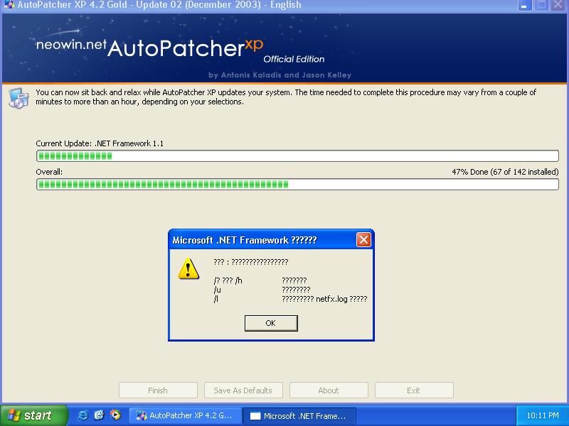

i think i've found a solution to the .NET question mark problem...
in "AutoPatcher XP\AXPFiles\NETFrame11.axp"
"%AutoPatcherXP_Dir%\ProgFiles\dotnetfx.exe" /q /c:"install \q"
should be
"%AutoPatcherXP_Dir%\ProgFiles\dotnetfx.exe" /q /c:"install /q"
(the backslash shouldn't be a backslash :) )
i'm getting ready to test it.
Thanks cpugeniusmv, After reversing the offending slash, ticking the .NET Framework box and saving as Defaults I burned a CD and tested on a clean install of WinXP SP-1. 114 patches and tweaks took 35 minutes and went off without a hitch. I checked Windows Update just to be sure and all was A-Okay! Thanks to one and all! :p

Some of these issues have been resolved, and will be fixed in the next release (january)
Instructions on fixing the last two errors:
1. Find the file called "NETFrame11.axp" in "AutoPatcherXP\AXPFiles"
2. Open it up in notepad
3. At the end of the line, notice the install \q"
4. change the backslash ( \ ) to a forward slash ( / )
5. Save the file
now those last two errors won't show up anymore.

no, it was a mistyped slash....a backslash ( \ ) instead of a forward slash ( / ) in the "NETFrame11.axp" file...
i ran the Dec AP on a clean installation (no november update) with the adjusted slash, and that fixed it.
You're 100% correct. I thank you all for your hard work in helpin' me stamp out these last remaining bugs! :D

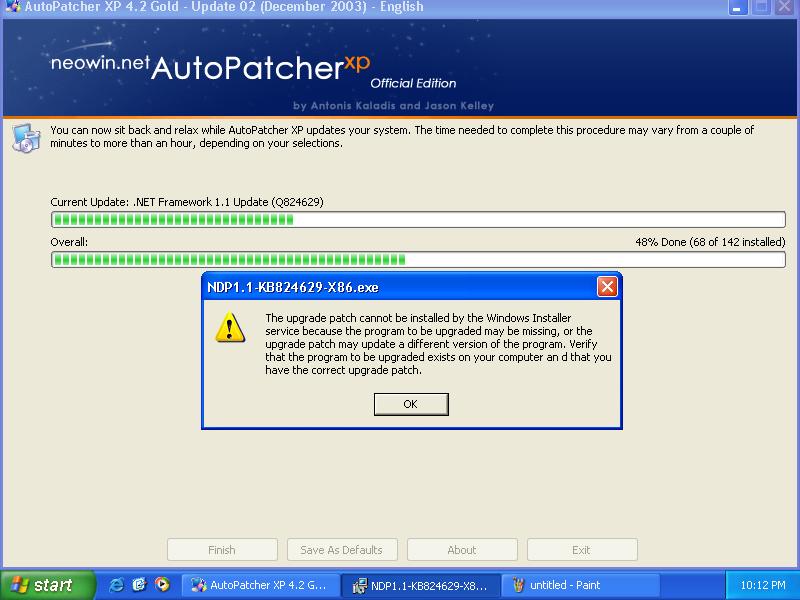

Okay.....1st my compliments on an outstanding program. Then will add some additional info ref'd to the minor problem with the .NET installations (on the Dec Full install program). I'm sure that this small problem has been addressed to some extent; but, this is what was noticed on 2 seperate computer updates. The updates were done from a burnt CD in which I had already corrected the \q to /q typo within the "NETFrame11.axp" file.
On the 1st machine, I left the default (both items ticked) to install both the .net framework and the update. An error ballon?? occurred for the Update installation (NDP1.1-KB824629-x86.exe) and the update stalled until you pressed the "ok" button and then preceeded until the autoupdater ending. Apparently neither the .net framework or the update patch installed; because, after rebooting - ran the windows update and it listed the .net installation as still needing to be installed. Now on the 2nd machine, ran same cd configuration but only leaving the .net framework install ticked and untick the .net update. This setup ran flawlessly from begining to end and installed the .net files properly.
