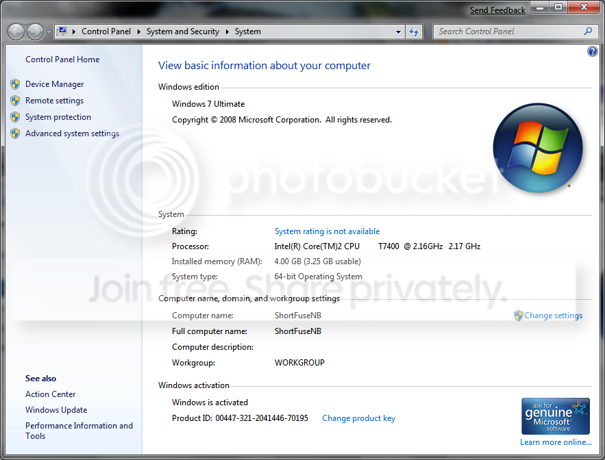

It's onboard (integrated) but not shared memory (GeForce Go 7400). It's a laptop.
I don't think I had this issue when I had 7000 (I think I had 4096mb in task manager). I did an upgrade though. Maybe could be the issue. I'll try a format if have 3.5GB bugs me and I can't wait longer to try the RC.

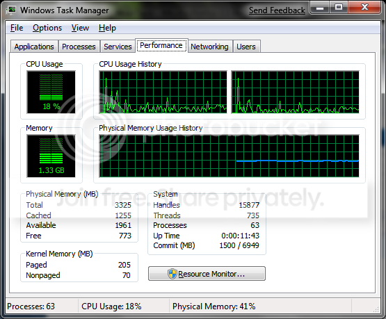

If somebody with 4GB of memory and build 7000 x64 can take a picture of their Task Manager Performance tab so we can see if build 7022 is bugged
Check your BIOS to see if it has reserved some memory or if you have an option similar to memory mapped hole.
If it is a laptop chances are it's sharing memory. What brand and model of laptop do you have?
Exactly the same usage as when you run a 32-bit OS? Pretty high coincidence.
It's a chipset issue with the M1210 laptops. Apparently the i945 chipset doesn't support 4GB on 64bit. For Core 2 Duo, the Santa Rosa chipset fixed this.

Well that sucks. No BIOS update to fix it?
Unlikely. Dell doesn't officially support x64 on this laptop. Also, it seems to be a hardware restriction of the Intel i945 chipset. The north bridge used in the Intel 945 chipset is limited to 2^32 addressable points on the memory bus.

It's definitely the i945 chipset. The problem is not specific to just my M1210. Even desktops that use the i945 chipset will only report 3.25GB in a 64bit OS. I read on a forum that somebody bought 8GB of ram and Vista x64 only reported 3.25GB (ouch!). The culprit turned out to be the i945 chipset.

Yeah but task manager reports it.
Hmm, according to dxdiag the video card has 1065MB of ram. So I guess the video is taking it but WTF 1GB+ of video memory.
If this was a desktop then I'm sure that memory would have been lost, like the guy who put 8GB on VistaX64and it only reports 3.25GB. At least it's not going to waste though I don't know how I'd use 1065MB of VRAM
