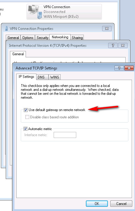

+BudMan MVC Posted September 6, 2011 MVC Share Posted September 6, 2011 on your vpn settings did you allow for access to other machines on your network, or just the vpn machine. Also your prob not going to want to connect through your network for internet from his network, so you would want to turn off default gateway on the vpn setting. I believe its here to allow him full access when you create the incoming Then on his vpn connection, he is most likely going to want to uncheck using your connection as his default gateway (internet) As to file sharing for him and pinging your network.. Your firewalls would have to be setup to allow access - so that could be a problem? Can he ping you? What is the output of his route print when he is connected to you. Link to comment Share on other sites More sharing options...

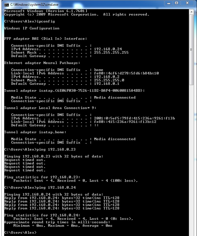

LexL Posted September 9, 2011 Share Posted September 9, 2011 Hello, I am the other half in this attempt at trying to bridge our networks from both our houses... Given Up using a Client based software becuase lets be honest we know windows can do this... This is making me feel like an idiot... I be honest i dont understand fully your route table above.. We have: - Made incomming and outgoing connections on the respective computers. - The computer with the incomming connection has: The Tickbox enabled for Sharing Network - The Outgoing computer: The tickboxes for the Default Gateway has been removed. At this time we have solved the rerouted internet issue.. We have Changed our Network IP's so that they are not the same. He can access my PC and other computers and NAS on my Network. 1/ I cant see or access him, is a VPN only one way? 2/ The attachment above is my system try - This all seems to be working at his end but i get a big ugly Red X. - I am connected to the internet and can access my own network What we have worked out that on my local network i am (192.168.0.2) and when the VPN is connected i am also 192.168.0.24 The outgoing pc is 192.168.0.23 - but i cant access that...(on the outgoing pc it shows itself as 192.168.0.23 Any ideas, going out of my mind... Link to comment Share on other sites More sharing options...
TurboTuna Posted September 9, 2011 Share Posted September 9, 2011 From that you're both still on the 192.160.0.1/24 which won't work, as you're seeing. If he is 192.168.0.1/24 change your ip range to 192.168.1.1/24 - which budman suggested... What I would suggest is have him change his network to say 192.168.1.0/24 vs the 192.168.0.0/24 -- and then have him ping your boxes IP once he gets logged into your vpn. Then he could try \\ipaddress of your machine to access shares. Link to comment Share on other sites More sharing options...

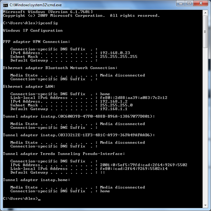

Axel Posted September 9, 2011 Author Share Posted September 9, 2011 From that you're both still on the 192.160.0.1/24 which won't work, as you're seeing. If he is 192.168.0.1/24 change your ip range to 192.168.1.1/24 - which budman suggested... [/color] My network IP range from my router is set to dish out 192.168.1.X whereas his is set to dish out 192.168.0.X so we've done this unless I am misunderstanding. It's the Server side of the VPN that is giving my the IP address 192.168.0.23 (according to ipconfig). Link to comment Share on other sites More sharing options...
TurboTuna Posted September 9, 2011 Share Posted September 9, 2011 Hello, Any ideas, going out of my mind... that shows your ip as being 192.168.0.x not .1.x Link to comment Share on other sites More sharing options...
Axel Posted September 9, 2011 Author Share Posted September 9, 2011 Could this even be a firewall issue? that shows your ip as being 192.168.0.x not .1.x Unless you're getting confused with the command prompt names as the we're both called Alex! (Users\Alex in cmd prompt title) It's showing me IP as 0.x on his network and 1.x on my local network. Is that not the IP that his network has just assigned me? Link to comment Share on other sites More sharing options...

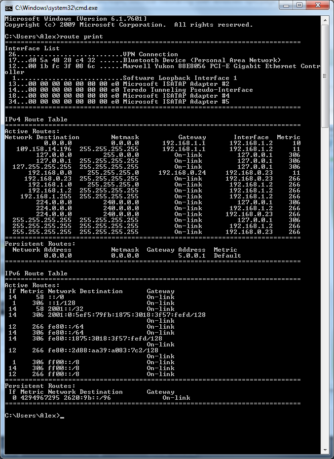

Axel Posted September 9, 2011 Author Share Posted September 9, 2011 FYI: My route table (As the client) Link to comment Share on other sites More sharing options...

Axel Posted September 9, 2011 Author Share Posted September 9, 2011 Okay we've somehow managed to make this work by putting a HOST and CLIENT connection on both machines. I didn't think this would be necessary. It appears that we couldn't achieve a single two-way connection (which is what we would like) but we can achieve two one-way connections! EDIT: OOPS I LIED! Apparently we can only have one connection running at a time rather than two simultaneously as initially thought. i.e. he can access my side but I cannot access his, or vice versa on the respective machines. This solution is not ideal as we were expecting two-way access. Link to comment Share on other sites More sharing options...
+BudMan MVC Posted September 9, 2011 MVC Share Posted September 9, 2011 For you to share access both ways your going to need to setup a site to site vpn on your routers. Your box server (host) has no router to the 192.168.1.0/24 network (client side) You could try adding it by hand, but I don't think his box will act as actual gateway. The incoming built in vpn is more of a road warrior setup, I do not believe it was ever meant to go both ways. Or that for the client connecting to it. What routers do you have? And you can setup a site to site. Or I seem someone is running hamachi -- do believe you could use that for your site to site setup. Site to site with machines on each network is a pain because no other boxes on the other networks will have routes for those other networks, which is why its better to do on the router, because all the clients on each network use that as their gateway anyway and talk to the router whenever they want to go to any network other than local, be it neowin.net or some other private network -- if the routers have connections between them then they will both route the traffic to the other networks. Link to comment Share on other sites More sharing options...
