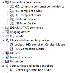

On device manager have you checked:
Human Interface devices
Mice and other...
Sound video game.....
USB controllers
Wouldn't it be connected by an internal USB, so it might be possible to disable the USB connection?
Also keep getting an unknown usb device, but the only USB item plugged in is the mouse, I can not seem to make the unknown device disappear, I have uninstalled it a couple of times.
^That is with the mouse unplugged, also I disable the PS/2 mouse and windows re-installs the driver at reboot. There is not any other mouse installed, so I can not figure out where the PS/2 mouse is coming from!
