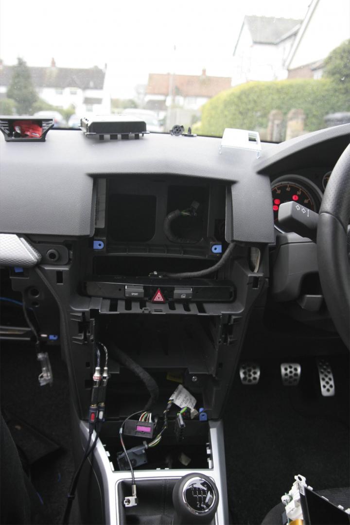

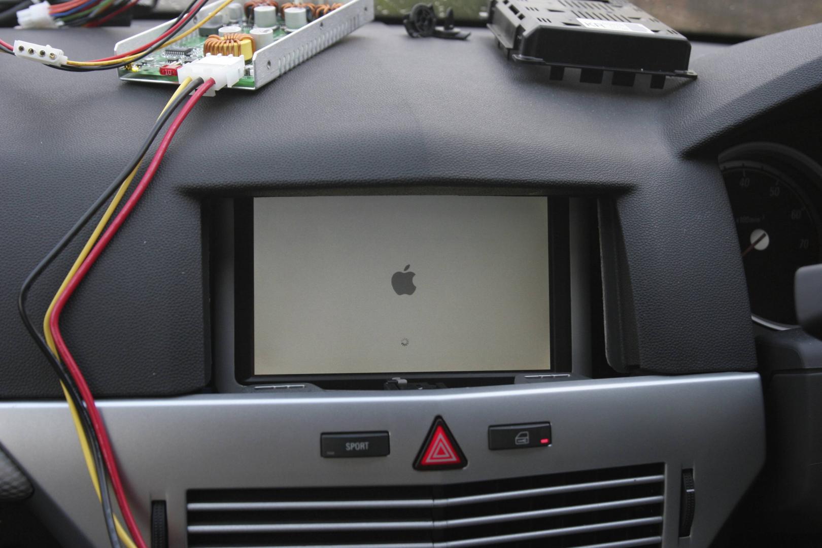

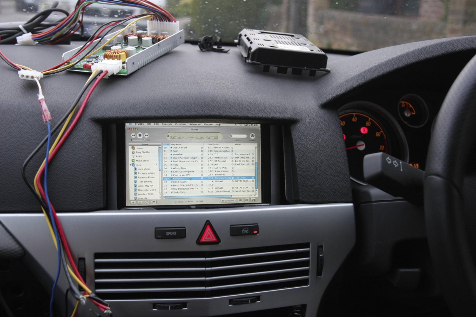

I actually put a computer into an Astra H a while ago. I ended up building a 2-Din box that contained a small computer and buttons on the front to replace the head unit, then a 7" touchscreen up in the panel where the Astra's normal screen goes. When I get home I'll dig them out.
As for speakers, you can get an adapter to break out the harness to a standard ISO fitting. From there, you can connect an amp or whatever to power the speakers.
I have thoughts about it too. It is a big project to integrate from scratch. If I were going for the Carputer model, I would have a Mac Mini/Apple TV (1st Gen) base with XBMC, otherwise a Tablet (Android/iPad) is also quite viable and probably easier as well. You can have a Low-Power NAS box to stream your music from. Shouldn't be hard to plug in a decent sound system into the headphone jack. Advantage of a Tablet is that it has GPS and Maps software already sorted (useful for driving) and you can take it out easily for security. The biggest problem for any Carputer/Tablet is customising the interface to make it safe for driving.
As promised, a few photos of my Astra H with a computer in it, as well as one with the dash pulled apart. The Astra doesn't bother with those tedious things called "screws", so the entire thing just pulls apart!
Everything did get cleaned up, but I don't have photos of it. Unfortunately for the project I sold the car - fortunately for me it was something way more awesome. Didn't dare rip that one apart!
