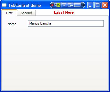

Hi all,
I am trying to place a label beside a tab control like the image(sample) below.
I placed the label but the label goes behind the tab control. These are the methods i tried to bring the control front but it is not getting displayed.
none worked
this.labelControl2.BringToFront();
[/CODE]
then i tried to invalidate for a repaint
[CODE]
this.labelControl2.Invalidate();
[/CODE]
I also tried to set the child index so that the label is the first control and will be displayed above all control like this
[CODE]
Parent.Controls[0].Controls[0].Controls[0].Controls.SetChildIndex(labelControl2, 0);
[/CODE]
A click on a hyperlink in one of the tab should invoke the label and display the name of the link on the label.
That's my requirement but i couldn't get the label displayed.
even tried to repaint the label manually.I am using dev express tabControl just an fyi.
https://www.neowin.net/forum/topic/1055880-c-label-beside-tabcontrol/
6 answers to this question
  • 0
I just did this myself... I added the Label control only after having added the TabControl. You can lay them on the canvas respectively; by default, they both render simultaneously as long as the tabs do not sit on top of the label.
EDIT: I now realize you're using the DevExpress TabControl. Why? That's the real problem, because it's basically a custom control. Try using the native controls first. That should have been highlighted FIRST as it's a separate control than the MSFT ones.
  • 0
Could you confirm whether thats WPF or WinForms.
Thanks
GE
Its winform build with devxpress controls.
I cannot remove the devxpress tabcontrol to use native tab control. those module were already in there and i am trying to add some functionality to it.
The whole application is build on devexpress and has been here for few years now so removing them is not an option.
