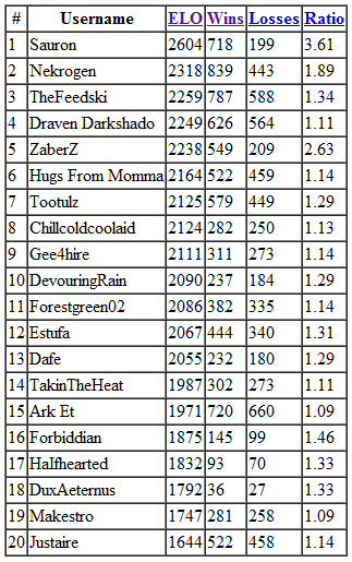

Produces this:
Name it whatever.php - upload it to /public_html - and browse to http://www.dominatedominion.com/whatever.php
Maybe someone else can work on making it rank in order? Just a little busy myself at the moment, otherwise I'll work on it a bit more later tonight/tomorrow :)

And with sortable headers:

Like so:
I won't take offence if anyone wants to improve upon my code (obviously replace 'results.txt' with 'http://www.dominatedominion.com/results.txt' in the fopen) :)

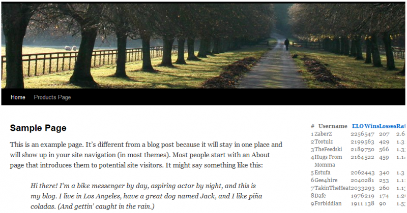

Ok so here is the problem. So I use bluehost for my hosting, and I installed wordpress on my bluehost account. However, to edit my wordpress I don't even have to log into my bluehost. Is this going to be a problem? Can I still put this script like it is on wordpress? Because I don't just want a blank page with these numbers, I want to keep it looking like the rest of my site.
  • 0
No problem... the code just needs wrapping in a Widget. Copy this into a file called leaderboard.php

Then upload it to /public_html/wp-content/plugins
Next go to your WP admin dashboard, click on Plugins, and click Activate on the new 'Leaderboard' plugin.
Now go to Appearance > Widgets, and drag the new widget into (e.g.) your sidebar.
And now you'll have something like this:
post-176093-0-29939200-1329889203_thumb.
Font sizes can be fiddled with afterwards. If you get a load of errors like 'fopen failed to open results.txt/fgets expects 2 parameters/blah blah blah', then you just need to change the path to results.txt in: $fh = fopen('results.txt', 'r');
Finally, I haven't just put my 'plugin author info' there to be anal - it's required by WP, otherwise the plugin won't show up.
As usual, any issues and we're here to help! :)
