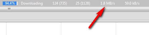

"I get my 6.8MB/s (yes Byte, not Bits)"
And your not on G wireless are you ;)
And I get
[ ID] Interval Transfer Bandwidth
[156] 0.0-10.0 sec 978 MBytes 97.8 MBytes/sec
Over my gig connection -- so what is your point?
Wireless is SHARED bandwidth -- does not what portion you try and choke up or down. Its not duplex and its shared.
