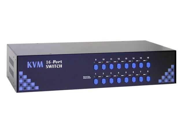

The one I am looking for is to connect 16 computers and manage them with one keyboard, one mouse, one monitor.
So is it really for what I am thinking or not?
The reason I am asking is the picture shown here :
Shows only one keyboard and one mouse ... while the ps2 model contains a mouse and a keyboard for each machine to be connected. This is what is confusing me a bit about it.
Please advise ... I do hope that I expressed it the right way :) .

Your english is pretty good, I understand exactly what youre saying.
That KVM will handle what you are needing. IF you ever have more than 16 computers, you will need something more, but for this point in time - that will be just fine.
I'm totally appreciated your time to review and check it.

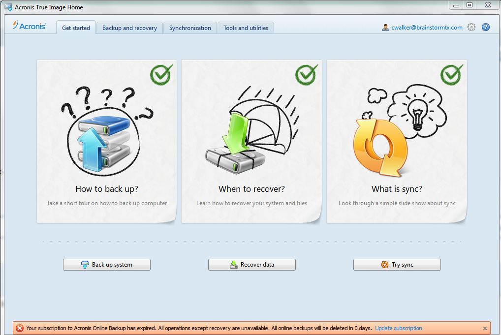

Since you're not using any server OS - snag a copy of Acronis True Image 2012 $40.
post-74610-0-12305600-1333354401_thumb.j
It is so simple, its funny. and works like a champ every time.
Ok, I will check it if it is that easy as you are recommending.
