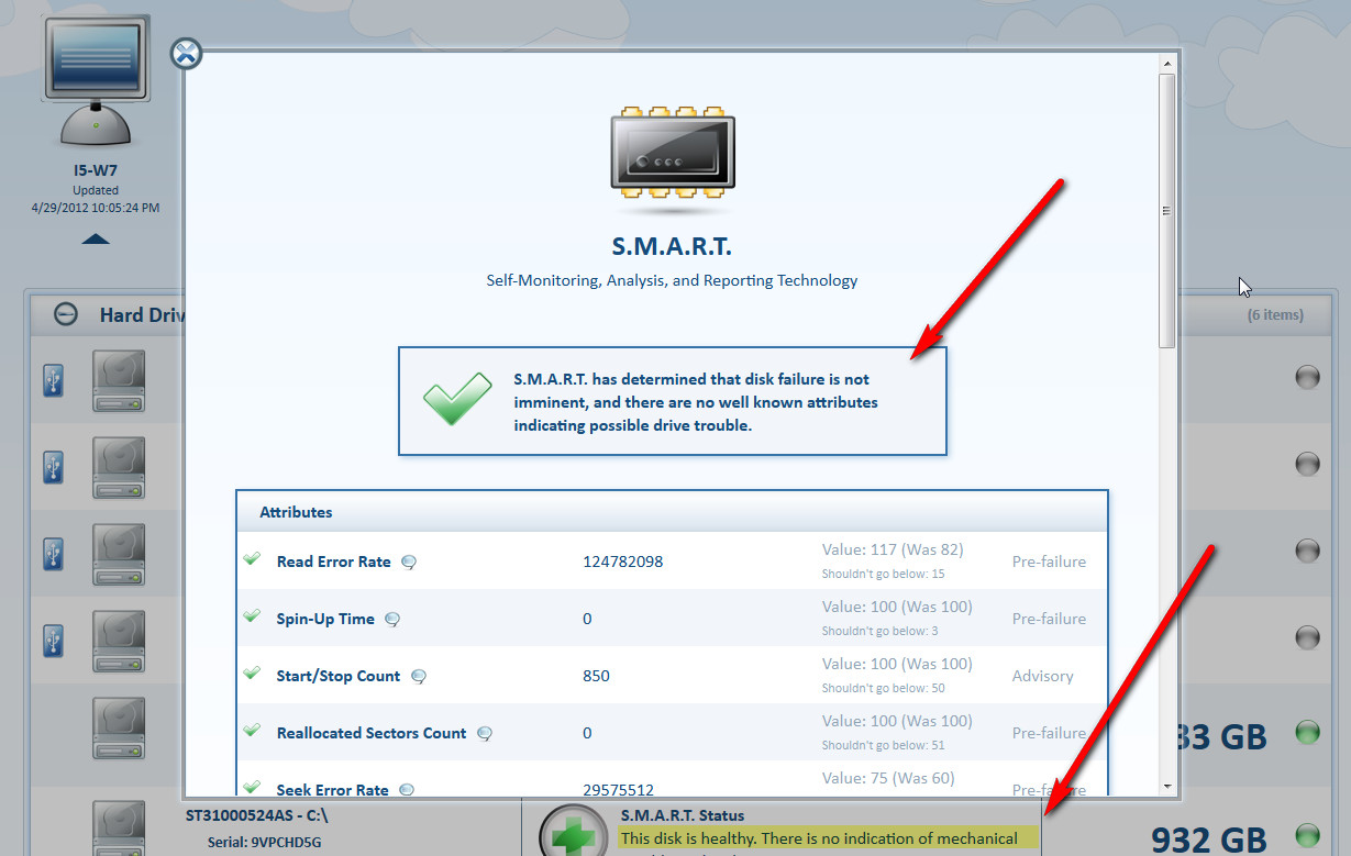

+BudMan MVC Posted April 30, 2012 MVC Share Posted April 30, 2012 And why have you not looked at the SMART INFO for this drive?? What does it say about the drive? Plenty of free tools for smart info.. Have you checked out https://bitflock.com/ example Within a couple of minutes you should have the info from smart if your drive is about to die, etc. Link to comment https://www.neowin.net/forum/topic/1073445-help-hard-drive-randomly-clicking-and-disappearing-from-windows-explorer/page/2/#findComment-594834091 Share on other sites More sharing options...
