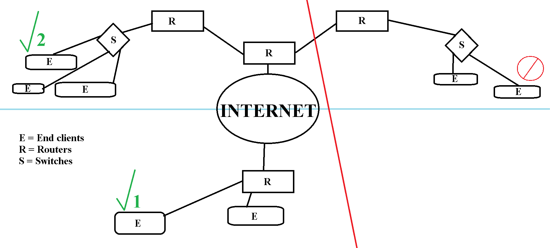

post-403188-0-18467900-1336147508_thumb.
I deserve Neowin artist of the year :p
No seriously, this is basically what I need to do.
Tick 1 in NO WAY SHAPE OR FORM can access that Red Circle end client. I need Tick 1 and Tick 2 to communicate. What I want to avoid (well I cant do directly) is having anything to do with the router(s) on the side of Tick 2 and Red Circle.

We are actually looking at the options of doing this. Currently we are looking at routers NetModule NB2500 to be on our side (Tick 1) and NetModule NB1600 (Tick 2) to be on the other side(s). They are both indeed VPN routers as you can see and "self configured" :) I was just wondering if there are other ways or options but as you and many other have commented it seems that this is the only way.

Those look like great products (I think one is even cheaper than the models we were looking at but again) I dont see nothing of this size:
http://www.netmodule.com/Products/NB1600-Wireline.aspx
The end device is NOT a PC: This has 2 digital outputs and a RS-232 which Ive been communicated are needed. Also the USB port is a plus because if not network transfers are required and as you see that is impossible (red line) for the client at hand to transfer from inside his own network.
