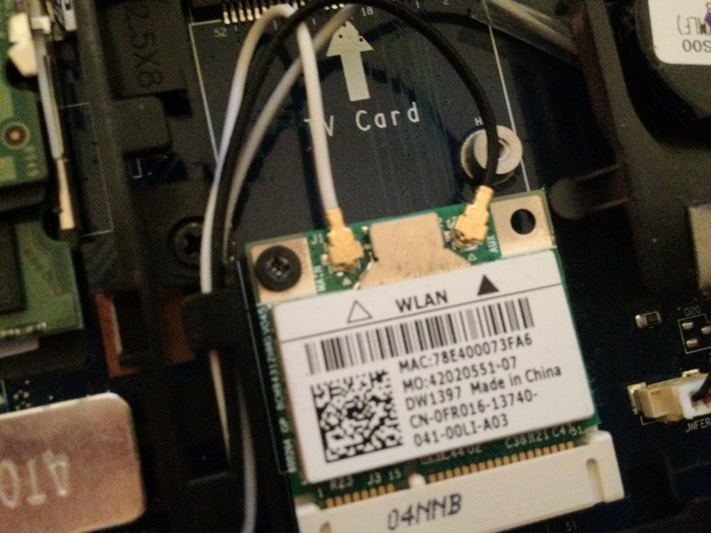

Axel Posted May 18, 2012 Share Posted May 18, 2012 I'm pretty much lost right now. Trying to remove the screw holding in a mini pci wireless adapter and the heads stripped with very little trying. Tried sticking a rubber band over it for traction and wont work, it's in ridiculously tight (thanks dell) and I honestly don't know where to proceed from here. Suggestions appreciated. Link to comment Share on other sites More sharing options...

Marshall Veteran Posted May 18, 2012 Veteran Share Posted May 18, 2012 I can't tell from the picture if the head of that screw has enough of an edge on it at the base but I would try needle-nose vice grips. Link to comment Share on other sites More sharing options...

wahoospa Posted May 18, 2012 Share Posted May 18, 2012 Get a small flat file that you can file with using the side of the file. Cut a straight path across the screw so you can get a small straight screw driver into the new cut. Charisma and Wolfbane 2 Share Link to comment Share on other sites More sharing options...
threetonesun Posted May 18, 2012 Share Posted May 18, 2012 Laptop screws suck to deal with, because they're so small. You can try to cut a slot in it, as mentioned above, to get a flathead in there. Alternatively, you can drill it and pop it out that way. Depending on the type of screw, you could probably force a driver into it hard enough by hand to screw it out if you want. Link to comment Share on other sites More sharing options...

Axel Posted May 18, 2012 Author Share Posted May 18, 2012 Get a small flat file that you can file with using the side of the file. Cut a straight path across the screw so you can get a small straight screw driver into the new cut. Yeah i might try this but a bit worried about the filings - will give it a crack over the weekend! Miffed a simple job is gonna take so long! Thanks for the replies guys. Link to comment Share on other sites More sharing options...
sava700 Posted May 18, 2012 Share Posted May 18, 2012 Last time I had a stripped screw in a laptop I grabbed my drill and a bit the size of the screw (not the head) and drilled it out... basically you can use a bit smaller and drill thru the screw (ONLY THE SCREW - Becareful here) so when the center of it is gone it relaxes its grip on the walls and should twist on out with a pair of needle nose. Link to comment Share on other sites More sharing options...

techbeck Posted May 21, 2012 Share Posted May 21, 2012 tape off the surrounding area...grab a drill and drill out the hole where the screw is. Or grind off the head of the screw. Orrr, grind a flat head screw slot on the screw then grab a flat head screw driver and remove the screw. Problem solved. Link to comment Share on other sites More sharing options...
smooth_criminal1990 Posted May 21, 2012 Share Posted May 21, 2012 looking at the thing, if you have a suitably sized flat headed driver, you might be able to fit it into the remains of the cross without having to attack it with a file. goretsky 1 Share Link to comment Share on other sites More sharing options...
