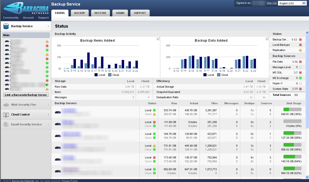

we use a barracuda backup appliance that we sell to our clients. it costs them around 100 a month for backup, we purchase the appliance and it sits at their site. With our discount, In around 10 months the appliance pays for itself, after that it is paying us. This is for the little backup 190 unit, anything bigger they need to fork up the cash. It is web based so we can monitor it for the clients very easily, we can also restore very easily from anywhere in the world. Most are willing to do this, no tapes to swap out, and it gets duplicated to 2 barracuda datacenters. And it does dedup.
here is what the web interface looks like
everything under main is a backup server for a client

This appliance is stored on the client site, do you have a "master" device at your site to manage all of them? Say you have 30 locations you really dont want to have to login to 30 devices, a centralized control panel would be ideal that shows you daily backup status of each location correct?

Each device sits at the client site, every one of those devices you see there is at each client site. You can see by the interface that I can get a health status at a quick glance. Anything with a red square is an issue, anything with a yellow triangle should be looked at and anything with green circle is good to go. I logon once to the main console there, if I see problems I have to treat them individually as you would any other backup scenerio.
