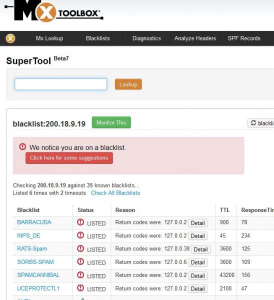

example -- from this lottery spam I won!!
Received: from smtp.epagri.sc.gov.br (smtp.epagri.sc.gov.br. [200.18.9.19])
by mx.google.com with ESMTP id ez8si7674016vdb.128.2012.05.29.05.06.33;
Tue, 29 May 2012 05:08:35 -0700 (PDT)
Got to love what looks like a government server being an open relay!! Anyway that IP is on several blacklists -- and really should have been denied to even be talked too!! Google can not really use such methods, much different userbase then a company business address. So they need to be more giving on sending servers. Clearly it was marked as spam and in my spam folder - but a business does not even need to talk to such servers.
post-14624-0-27033800-1338735437_thumb.j

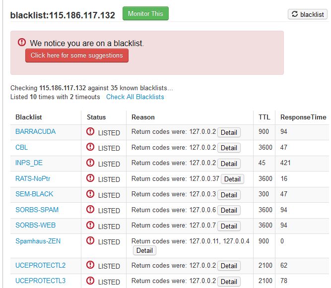

here is another spam in my gmail
Received: from f3ufo2lho0j ([115.186.117.132]) by mx.google.com with ESMTP id o8si7651725igl.64.2012.05.28.07.03.16;
You know the pills that are suppose to make your junk bigger ;) Well look at then, again on a **** load of blacklists and their server should of never been allowed to even talk to email server.
