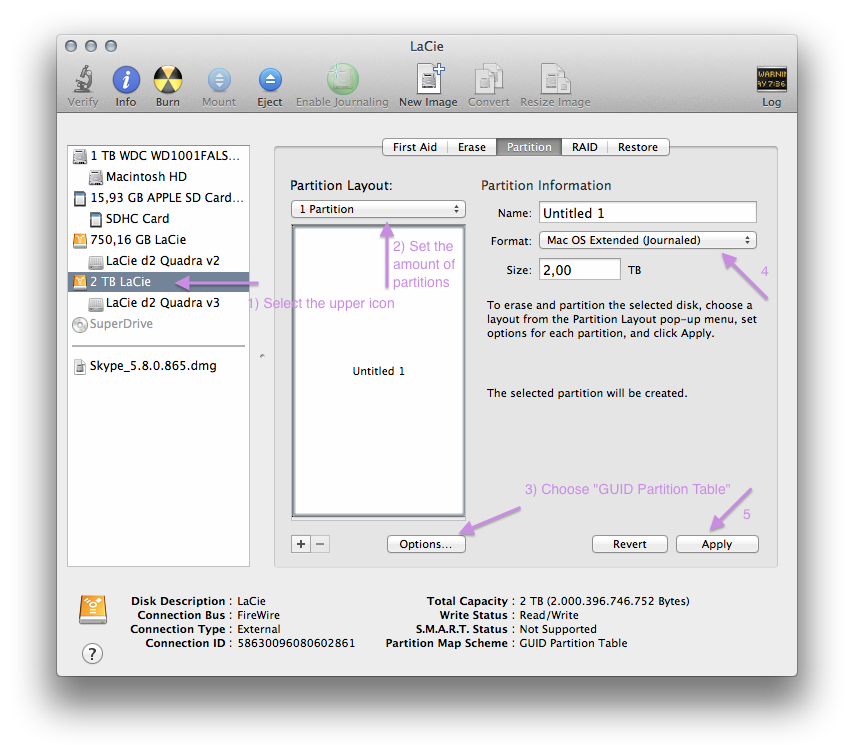

To install OS X onto an external drive you just install the system as you would normally, only select the external drive instead of the internal one. Easy peasy. :) Be sure you format the external drive using a GUID Partition Table and as Mac OS Extended (Journaled). (See screen shot for instructions)
