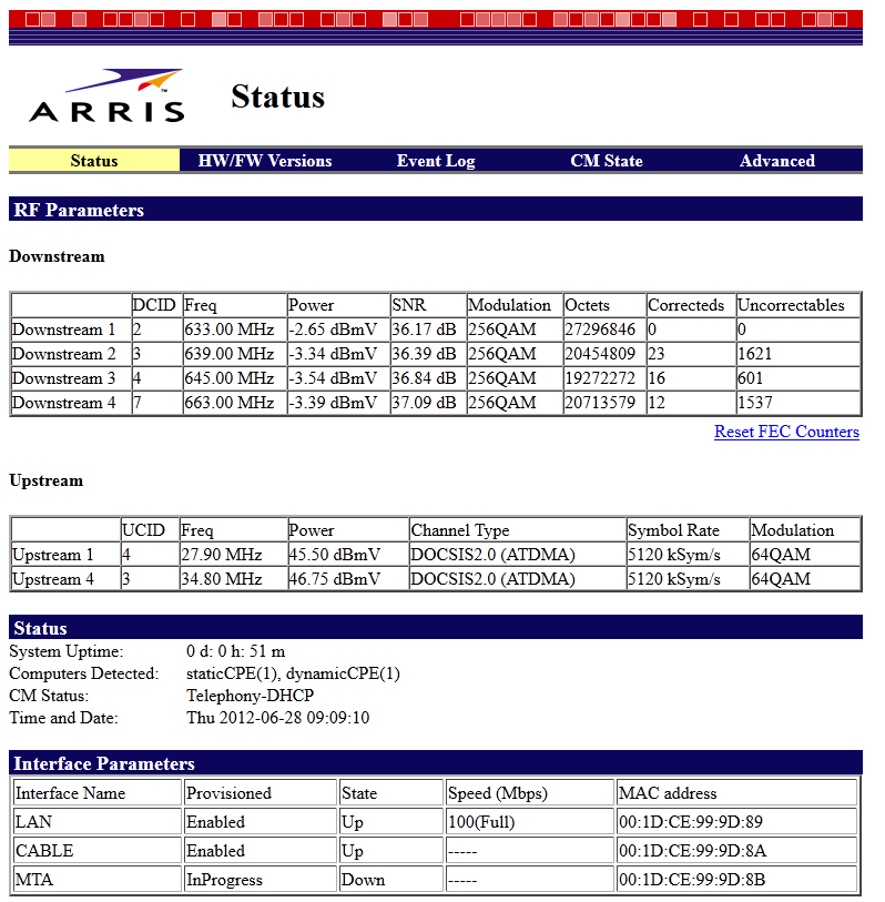

Not wireless! I spoke with Comcast tech support and did a series of tests including plugging the modem directly into the system, and then with there speedtest (speedtest.comcast.net) the highest I got was 8 Mbs so they are sending a tech out tomorrow to test things here! The speed that I should be getting is 22/Down 5/Up and seeing as the down speed ggot nowhere close to that, i thing there is a problem...

You asked, I delivered! :) Also what I am able to gather, it is supposed to be 22/Mbs period, not including power boost.
post-243659-0-13680500-1340892662_thumb.
The modem is a telephone modem as well, even though we are not using digital voice from them, when the installer came out he could not get the regular modem to work, so he put this one into the mix, and it worked, even though the issue was on comcasts side (trapped in activation)
Your signals look good there so. Seems you have the ARISS T722G modem?
ARRIS Touchstone TM722G
http://www.ebay.com/itm/ARRIS-Touchstone-TM722G-Telephony-Cable-Modem-DOCSIS-3-0-4x4-Channels-/
Comcast seems to be doing 8x4 or close to it so maybe you can benefit from a better modem? The reason being they have a channel 7 listed there on 663mhz. Maybe 4 channels is not enough to help ease congestion so the pumped it to 8 but you only have 4 so you are still stuck with the congestion issue.
That is the modem you have though? i I was making an assumption based on the screenshot.
Ask them the person that shows up if they have a newer version or maybe a Cisco one since you aren't using voice from them anyways. Since you are leasing you could go get a Moto 6141 from Amazon or a Zoom "J" version and save yourself the fee :). Both of those choices are 8x4 modems. I would get the upgrade if they have it first though to see if that fixes the problem before buying a modem :).
