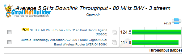

Yup that smallbuilders link is good place to start. And from those charts, unless your talking a 80Mhz Bandwidth with 3 streams then yup your wireless is not going to be able to handle it.

On there I show 450 (3stream) using 80 mhz bw in the low 100s for average for the 5ghz

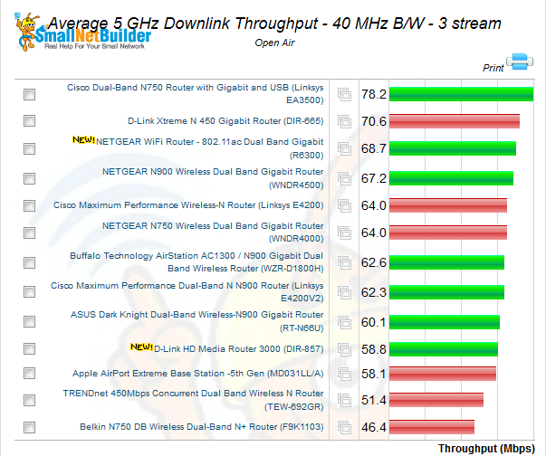

From what I can tell from that database is your typical wireless N router just not really going to cut it for those kinds of speeds without being a hit in the performance. Here is 3 stream 40 and its just not really cutting it for average download on a 75mbps connection
If you look at your typical 2.4 3x download 40mhz there is the 1 that amped router that looks like it would be ok, but the others are below the 75 mark.

As much as I respect Tim at smallnetbuilder, I find his results are usually quite a bit lower then what is actually achievable.
The fastest 5Ghz, 3 stream, 40Mhz downlink result he's ever recorded was 104.5Mbps (with a Linksys EA3500). Yet here I am, getting 144Mbps of throughput on a wireless system that is one floor down and two rooms away from my wireless router. Yes, throughput. Not link speed. I mean I have a file transfer currently running at ~18MB/s. I'm not breaking any LAN speed records here, but it's more than enough to allow me to happily stream full 1080p Blu-Ray rips (i.e. 20GB+ .mkv files) from my home server to my HTPC, without a hitch.
