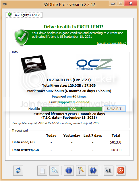

edit: 8 years, ntb.
Mine is both bigger, and more used!
My penis SSD is way better than yours :p
(I'm just kidding. I'm sure you won't be offended, but thought I had better say so >.<)
LOLLLLLLL........
It's not how big it is, it's how you use it.. :shifty:
I find it curious you've powered it on 60x but it's been online for 5000+ hours. :o You really don't like turning it off eh?
That, and certain firmware updates reset certain smart values (specifically powered on times. It's the only one I have ever noticed).
I work and play off of this machine, It doesn't get turned off much :p
