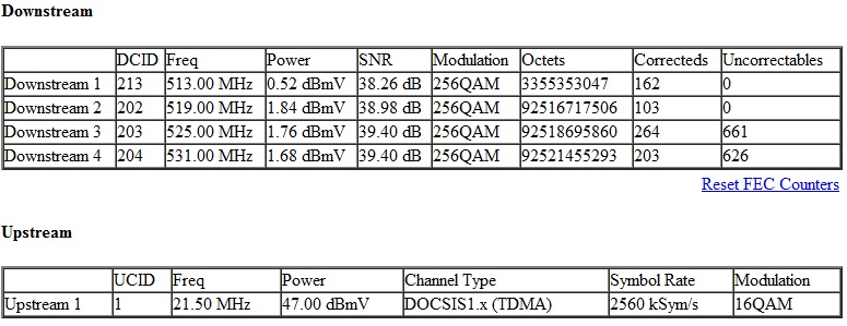

Okay, on to finding one culprit at least. I bypassed the splitter behind my TV, it is needed as one line needs to go into the modem, another into the cable box. Main in coming from the wall (which is I believe coming down from the dreaded crawl space).
So bypassing the splitter completely and going straight from the wall into the modem produces these results.
Definitly still not ideal, but much better than with the splitter.
So question is, how do I fix this? I need the splitter, so is it just a simple fact of I should pick up a new splitter and some new coaxial cable?
The coax cable being used is also unnecessarily long as well.
Believe I am going to take a ride to Radio Shack to pick those things up right now, but will wait to see if anyone replies.
Yeah see, this is the same modem with the splitter.
Off to radio shack to pick up some new (shorter as well) coax cables and a new splitter. I think they should help as i have to imagine the splitter and coax that is there now is also pretty old.
Brand new splitter and all new coax cables did jack. Same exact numbers. Luckily Radio Shack packaging is easy to put back together. :D
So obviously any splitter is going to make the numbers go up, so I have to get the numbers down before the line to the splitter. This does mean from the outside of my house through the crawl space though, so this is a project for Cablevision, absolutely. Now, to see if I convince them they have to do it.

DOCSIS 2 for upload is normal and better than 1.x that some use (Time Warner in some places). They are upgrading though so guess most people wont see that. Using 1.x also is good in some areas where there's lots of noise on the line. On Comcast with multiple upload channels you'll see a mixture of 1.x and 2.0 A-TDMA and such to help get the most out of the available frequencies they have.
As for DL - I would have told you not to bother with the new splitter as I said your option is to try connecting closer to the line that is connected outside. Since you said that line is way too long anyways, you might want to get a direct run if possible. Dunno your house layout or how far away but basically that's what you need to do. With the splitter though, did you get a 5-1000mhz one from radioshack? Sometimes they have some crappy ones too anyways.
Even if only temporary, connect the modem to the tap even if that means just running a cable thru the window just to see how strong the power is at that connection by the Verizon box.That way you know what you can expect. If it's crappy there not much can be done and you'll just have to get Cablevision there. They will however say that since you aren't really having an issue it's not a problem (and in reality it's not) but just something to keep an eye on, don't stress too much about it till you start getting disconnects :D Keep an eye on your SNR mostly as that's where trouble starts happening when it gets below 30 - 33 and up being best - See mine below of how good you want it to be (might not be possible however :))

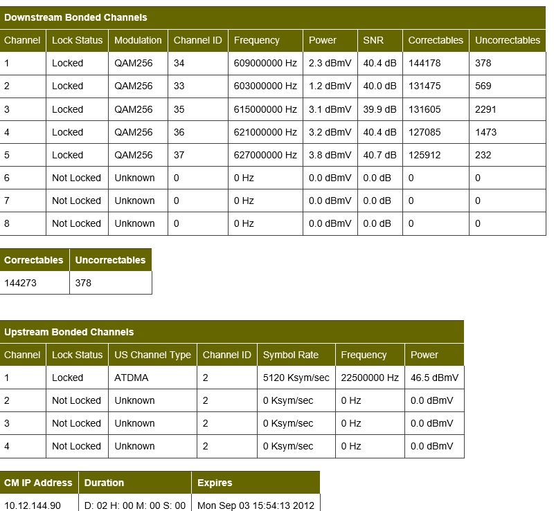

Here are mine in case you were curious:
Here are my Labor Day weekend Sunday afternoon results in an apartment building area with lots of people home. I'm on 5Ghz WiFI.
Not much to worry about as you can see :)

I am resurrecting this old thread just to make sure, as I have Cablevision coming out tomorrow between 11AM-2PM...
I want the signal levels on my modem as close to 0 (zero) as possible correct? Or do I actually want it to be on the positive side closer to +15?
This is what I am referring to, under the Power column. This is actually an old screenshot, they are all at around -10 these days.
