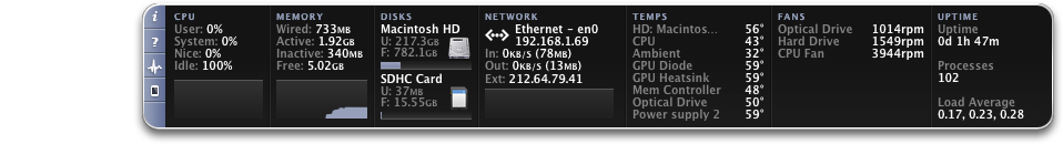

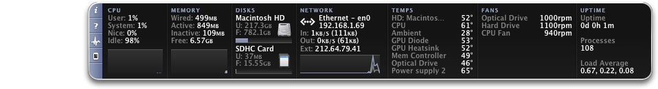

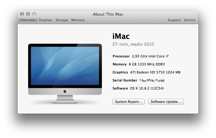

I'm going insane over the behavior of my 27-inch, medio 2010 iMac. The CPU fan continues to spin up even though the iMac doesn't do a thing. I've reinstalled OS X Lion multiple times, I reinstalled OS X Mountain Lion several times. I did PRAM-resets more times I can count, same goes for SMC resets. Today I even disconnected the iMac, laid it down on my bed and cleared all the vents with the vacuum cleaner on the weakest setting. The other day a friend of mine walked in and immediately asked why my iMac was making so much noise.
The first picture shows the CPU Fan right after startup. The second less than two hours later. I haven't done a thing with the iMac except play music and browse the web a bit.
How on Earth is it possible the fans spin up, sometimes over 4000 rpm, when the CPU sits next to idle most of the time? The worst part is they won't power down once the iMac cooled off. There are no optical drives in the SuperDrive either.
The measurements are in Celsius. The room temperature averaging at 20,5 degrees throughout my apartment. It's only 14 degrees here in Amsterdam.
post-128385-0-15321200-1348764232_thumb.
post-128385-0-38335300-1348764664_thumb.

assuming your temps are in Celsius it is spinning up because the chip is hot. Is there anything to justify the chip being hot? Dust on the HSF, high ambient temp, etc?

I can't really say for sure how much dust has accumulated inside the iMac itself, but judging by how little there was directly underneath the grill I seriously doubt it's a lot. I tried looking inside with a flashlight but everything seemed clear.

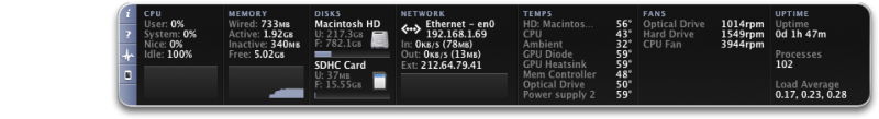

UPDATE:
Okay this is incredibly interesting. I'm now 100% sure this is indeed a software issue, rather than a hardware related one. For whatever reason OS X Mountain Lion is telling my iMac to increase CPU fan speed in order to cool off. But apparently this is a one-way street. As time progresses the fan speed just continues to go up until it hits a maximum of about 4150 rpm. Like jamesyfx noticed they it will continue running at its maximum until I do a full shutdown. So for whatever reason OS X Mountain Lion won't tell my iMac to reduce fan speeds once it cooled off.
After a lot of Googling I noticed other people having the same issue with OS X Mountain Lion. Not just iMacs but MacBook Pros too. One person came with the suggestion to temporarily download and install iStat Menus 2, set Fan speed control to "Medium" (it's on of the default "rules") and then return to "Default". In literally an instant my iMac's CPU fan would drop from its maximum of ?4150 to a quiet 1940 and then continued to drop.
Check out the below screen shot and note the uptime: Over 6 hours and a regular CPU fan speed of 1885 (it's still dropping as I type).

+jamesyfx    352
It does a similar thing on my system, CPU fan speed drops down to a steady 1190rpm when I set to default.
Seems like it kicks the default behaviour back in once you set it as such.
My iMac is a completely different model to yours, so the issue must be software related.. and I think using this utility has proven that.

Yeah that's exactly what seems to happen. iStat basically slaps OS X on the wrist telling it do proper fan control. After a while CPU fans would indeed drop to an average of 1190 rpm on my model as well. Here I was thinking my CPU/GPU fan was constantly triggered because it couldn't handle the new OS X Lion/Mountain Lion graphics effects. But that's not it either.
Anyway, it seems like you can uninstall iStats Menu from your system until you do a SMC reset.
