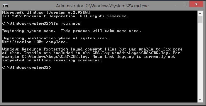

For the last few days, I have been experiencing lots of slow downs again. Whether it's on startup or just loading apps. Also had several "Windows Explorer has stopped working" errors. So I just did Sfc /scannow and I got the following error.(See screen.) I have attached the error log.

Run a CHKDSK /F yet on that drive?
Yes. I have done that a few times. It stops at 45% and then goes to the login screen.
Looks like you're getting folder permissions errors. Did you modify anything? Was it a clean install or an upgrade?
Haven't modified anything. Clean install quite awhile back.

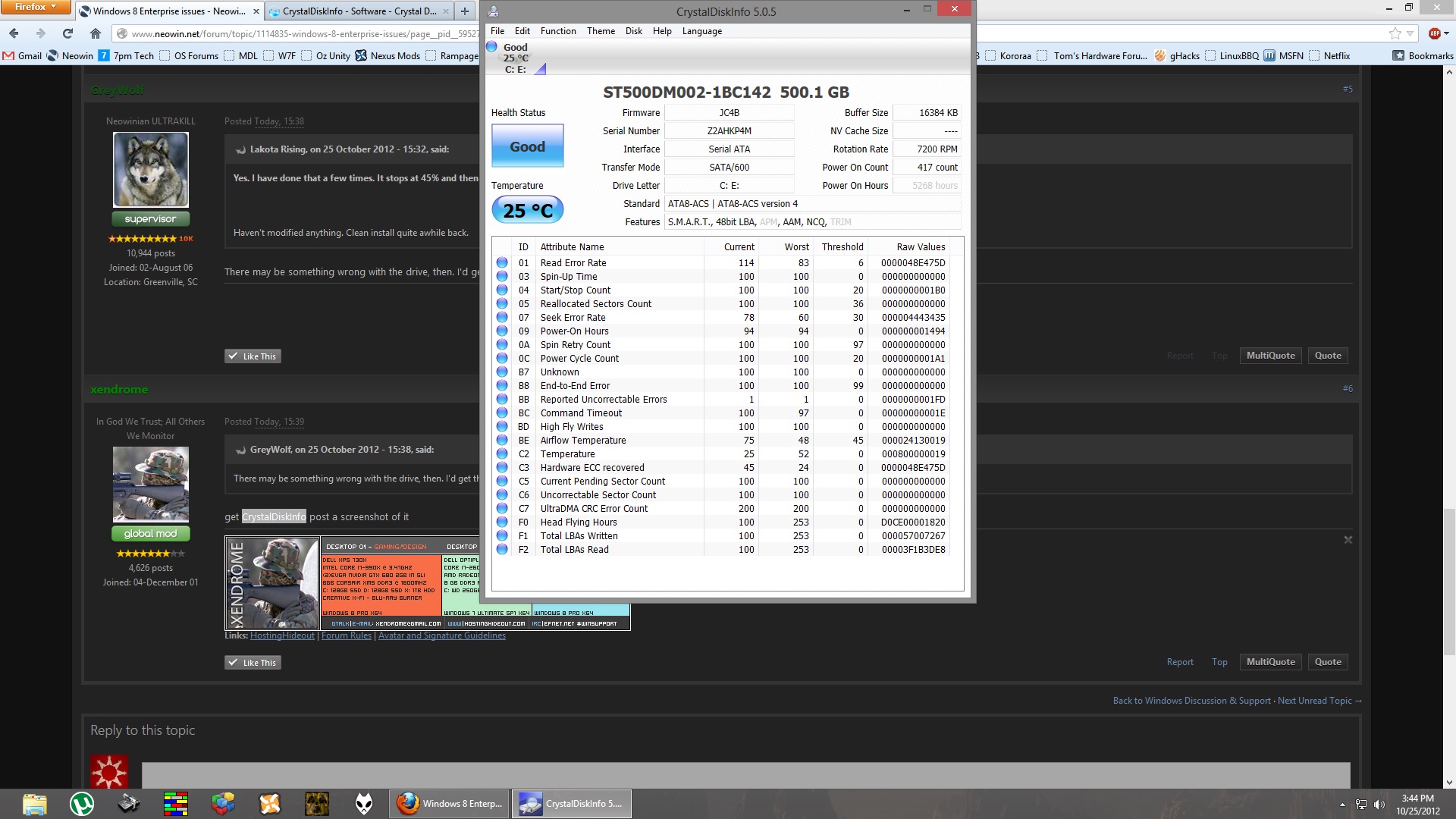

There may be something wrong with the drive, then. I'd get the diagnostic tool from whatever company manufactures it and give it a run.
I did several refreshes before I took the screen.
I've seen people getting bad info from Crystal. I suggested the OEM's diagnostic tool because you can use the output from it to RMA the drive if you need to.
So I need SeaTools then?

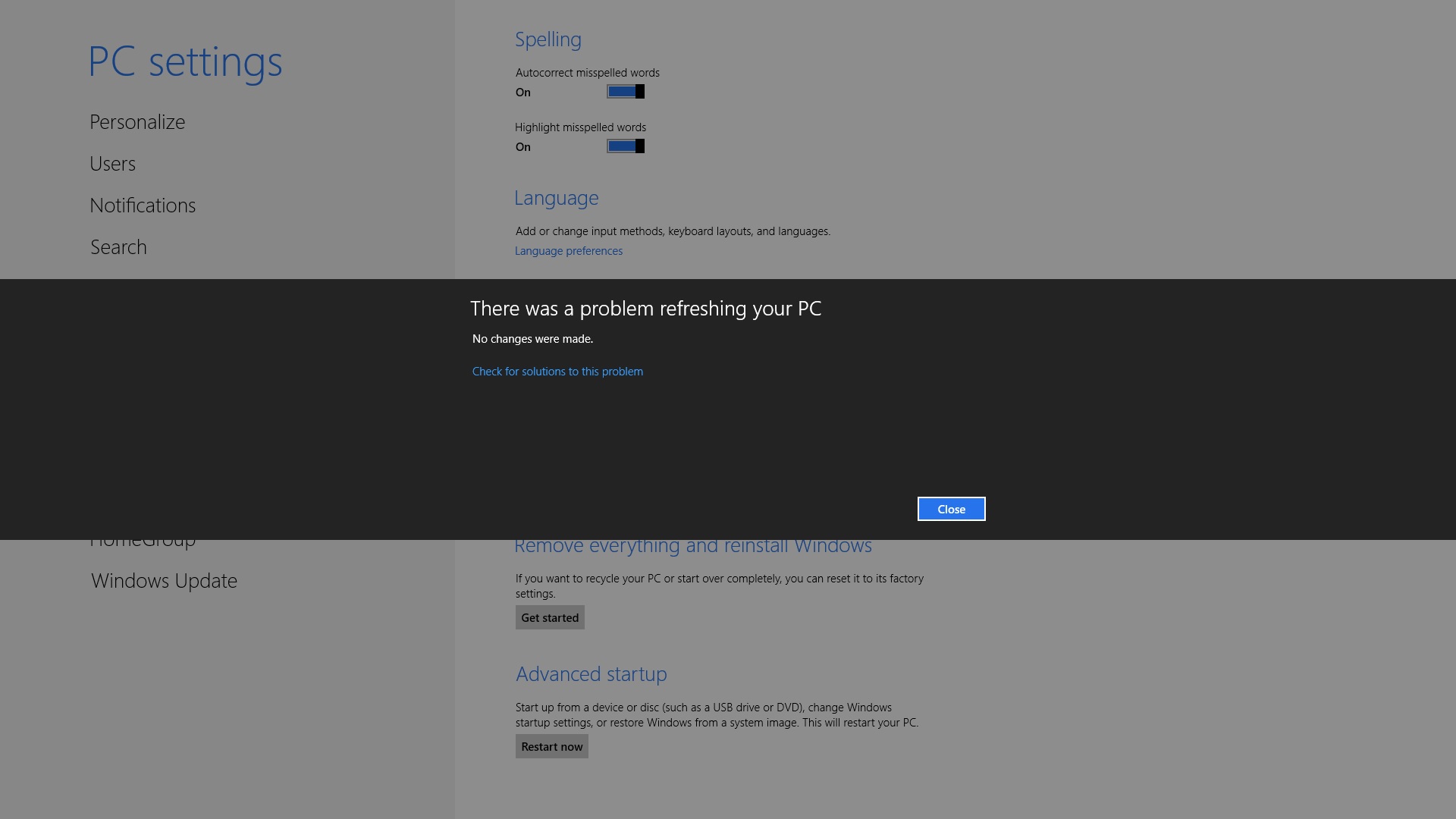

Well, I dl'd the ISO burned it to a CD-RW and ran the long test and there is no issues with the HDD. I'm thinking I'll just do a reset/refresh on the drive.

Have you made sure the install media is good? I've seen corrupt install media lead to issues like this.
If that's good then I recommend a test on the RAM.
I tested the ram last night. The install media is what I dl'd from technet and burned to flash. Works fine. I tried loading it up on my wife's pc and it works fine.
Also, when I click check for solutions, it starts to load then it disappears.
Hmm it sounds like the original install just went wonky for some reason then if the hash matches for the install media.
I've seen that happen a couple times, but not often.
Ok, so let's say it went wonky. Do I have to re-dl the ISO then?
