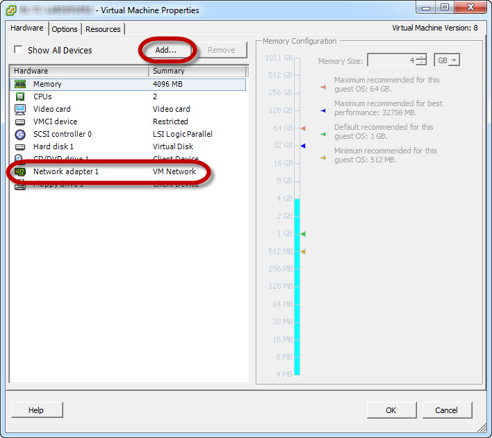

And what physical nic did you connect to your vswitch that you put your vms on?
So for example
I have a Lan vswitch that the physical nic in the host is connected to my real world lan switch
Then I have a wan vswitch that host nic is connected to my cable modem so that my VM router can route and firewall traffic between internet and my vms and my physical devices as well.

my VM gets local address 127.0.0.1 .... my server which is hosting the VM has an ip to the network and I use vsphere to connect to the server and the VMs but I cant connect to the VMs obviously any other way ... I do not see anything about the Vswitch on esxi or the vsphere I may just be blind and its and switch option is blanked out on the physical ESXi interface.... so what you suggest is changing the VMs 255.0.0.0 subnet to 255.255.0.0 manually ?

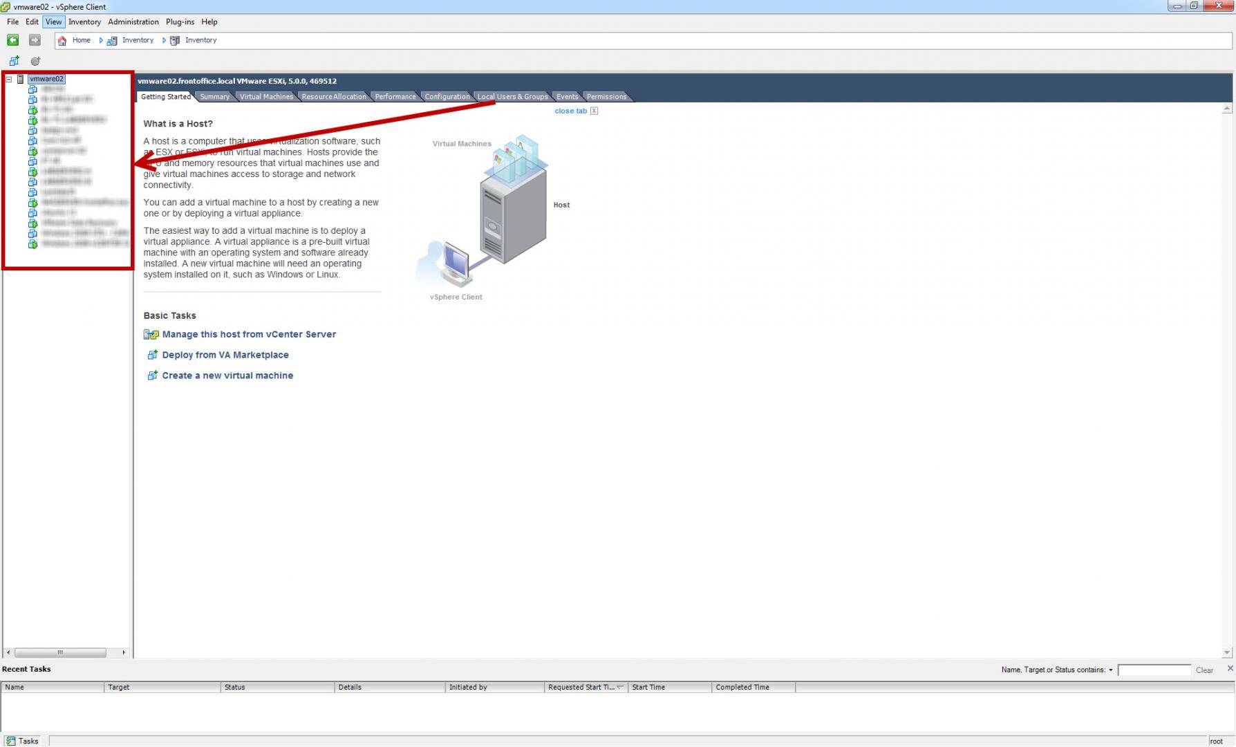

I have never seen that kind of layout on my vsphere :s ? also the NIC i have no idea what one its connected to xD i just connected al my E001 thing on the vnetwork

I know that im not stupid ;( I guess I didnt explain my self enough (you have seen my posts im not very good at explaining ) .... I know 127 is a loop back I use it every day when testing server scripts ;( its just I didnt know why the DHCP was not giving it an IP ... then i realised the DHCP was not working ... so I have manually set it a IP and the subnet and now im just trying to connect to my linux server but I do not think it has SSH or FTP installed / running and I cant do that as this is an isolated network (I am currently within a lab at university with the isolated network )
also I found the Vswitch its all on the same NIC2 so thats all gravy
