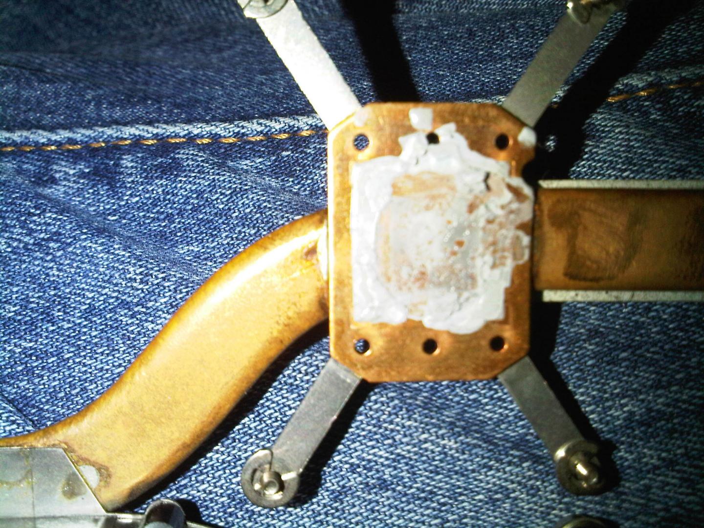

Now... Back to the problem... I tried all the software alternatives and it didn't work. Seems it is a video card related problem.
I've found this:
http://www.insidemylaptop.com/clean-replace-cooling-fan-dell-xps-m1530-laptop/
And I believe that by "Thermal Grease" he's referring to thermal paste, isn't he?
I'm taking a picture and posting it right now to see if that's the problem...
Well well... Afterunscrewing everything for taking some pictures, I decided to screw it the way "it's meant" by screwing following the numbers.... Boom! The computer does not make a loud sound to boot up! :o
It's still scorching hot though. Here are the images... I believe that the Thermal Paste is the true culprit....

Yup. You might also want to check into getting a thermal mat. This is the one I have. Very quit and does the job. http://www.target.co...page.vertical_1
It won't solve your issue, but it might stop your computer from shutting down on you.
What paste are you using? Try some Arctic Silver on it. Be sure to wipe all the old paste off too. I wipe all the larger globs off with a paper towel and clean it up with some rubbing alcohol.
Also, try clocking down your GPU. Unless you're gaming it shouldn't affect performance but it will reduce temps. Just reducing all (max) speeds by around 30% can be a huge improvement. You can use this to do that: http://www.nvidia.com/object/nvidia-system-tools-6.08-driver.html - it adds an extra category in your nVidia CP.

Regarding the Artic Silver. I'm going to look for one tomorrow to have it as Backup. I have one that my friend gave me, just so I could try to see if that was the problem.
On the other hand... I'm into the replacing the thermal paste. FOR CHRIST SAKE! This MUST BE THE PROBLEM, because the DAMN THING is hard as steel. It looks like the paste was soldered to the heatsink (The GPU end). On the other hand, the CPU went off flawlessly....
So! 1 hour and a half later I came up to the conclusion that it IS indeed the Thermal Paste which was the problematic here. I applied a small layer to the GPU as the Internet suggested. The results were great! The idling temperatures went down from 68?C to 60-62?C. The Computer didn?t make a single noise when it booted!
But? When I threw it a 1080p video it skyrocketed to 95?C!
I then decided to apply more thermal paste to see if it would work.
Before that, I decided to run a ?pre-boot System Assessment Build?, which it usually failed before applying the thermal paste and has yet finished.
When is finished I?ll post back the video performance and temperatures.

I?m happy again. I thought I would need to replace the laptop due to this crappy issue :p. So this means that my goal for building a desktop next year stands!
P.S: If it still giving me trouble, I?ll just put it some Artic Silver 5 after I get some, and that?ll finish the job ;)
