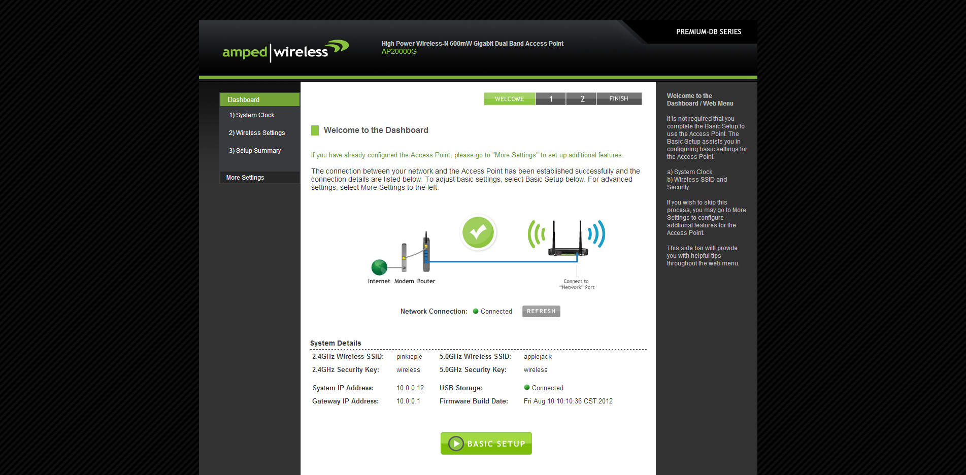

Unboxing and setup: Initial setup was extremely easy! It was actually easier then setting up my Netgear WGR614 Router. Just hook up the antennas, connect the Ethernet cable to the router, then plug the power cord in and go to setup.ampedwireless.com from a wireless client and enter a little bit of info in like Wi-Fi name, etc. and then you?re connected. Please note: If you are using this with an Amped Wireless Router you must input the AP?s IP address instead of setup.ampedwireless.com because that defaults to the router?s config instead of the Aps.
The initial setup wizard was very easy and quick and should get most typical users setup within 2 minutes including a reboot of the router.
When you first setup it?s protected with WPA and the password ?wireless? for you. This is a good thing unless you have neighbors that know that you have an Amped Wireless AP. LOL. I suggest changing this immediately as well as proceeding to the next paragraph?s instructions.
Going to setup.ampedwireless.com is much easier then accessing by an IP address. This is much easier to remember! Please note, however the config page is not password protected by default and a login must be setup after initial configuration. It can be accessed by doing the following: more settings>management>password. For the first time it did not accept my username I entered in. I chose a custom name and password and the AP did not accept it. However I chose the name ?Admin? and that was accepted. Strange.

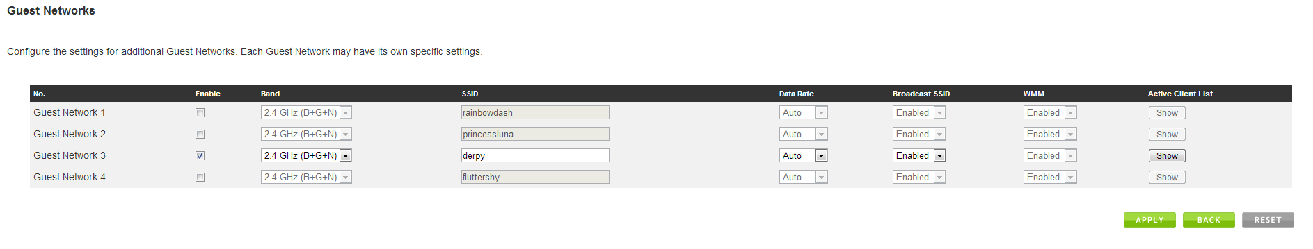

From here you can configure and setup guest networks! You get 4 for each band (frequency)

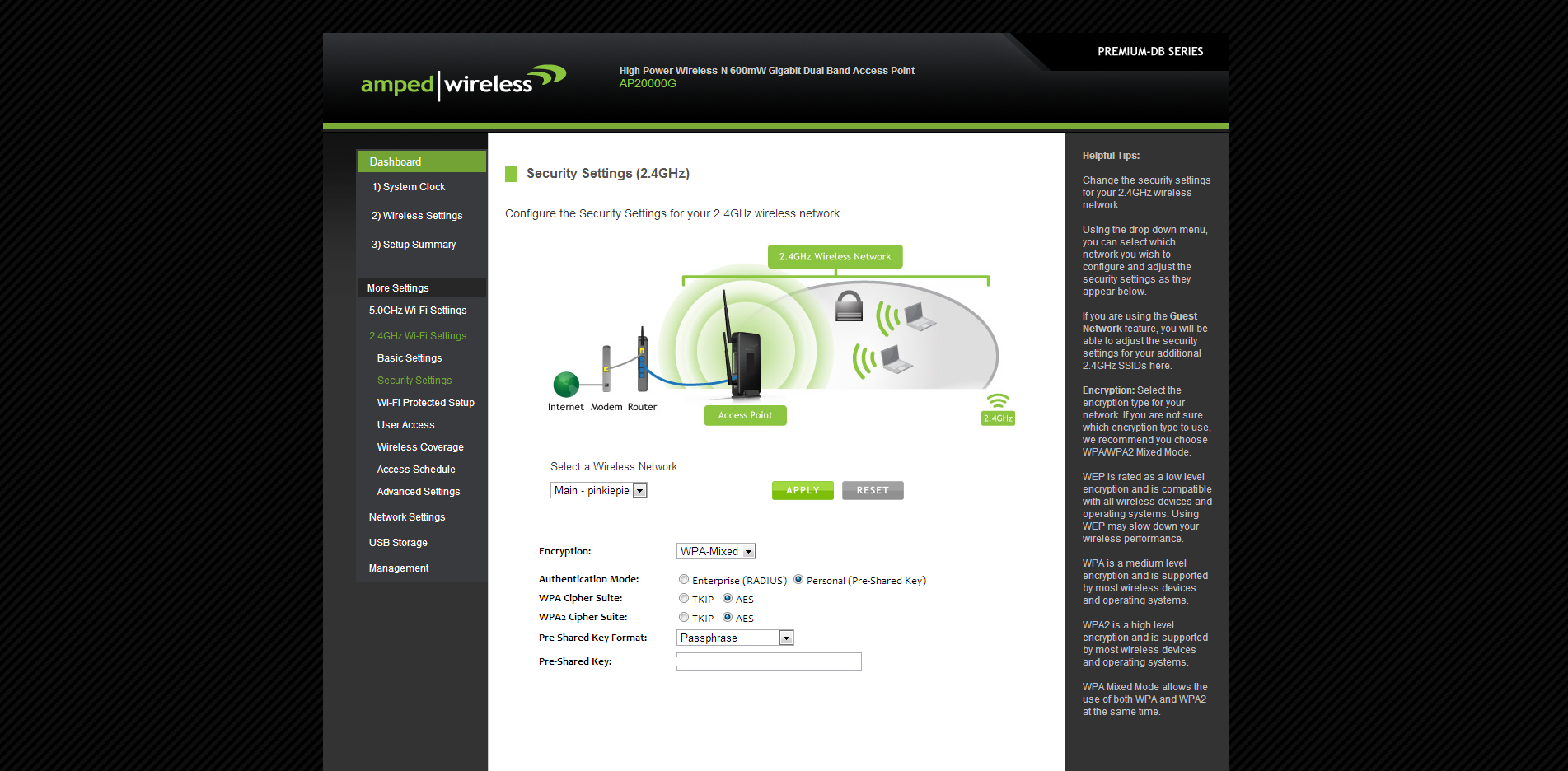

As you can tell I?m a brony? LOL?. From here you can configure your security settings.
You can setup the security type of the guest networks from this screen here as well.

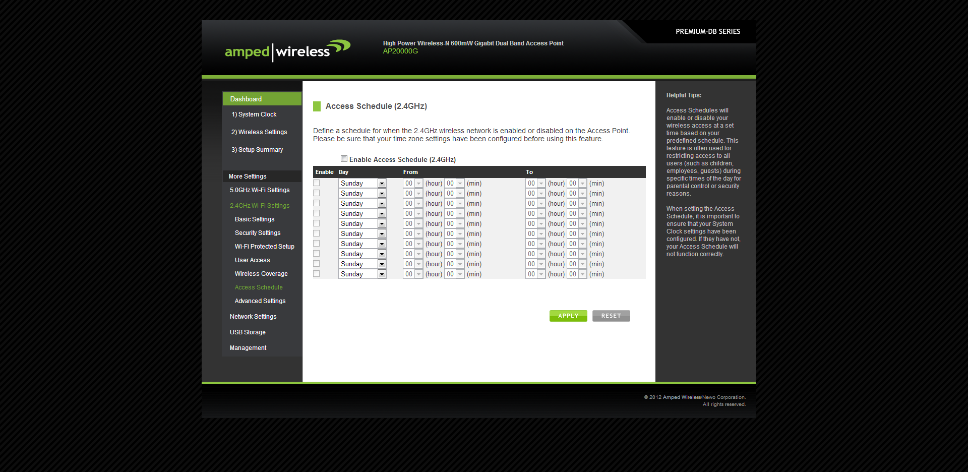

From here you can setup an access schedule. For example if you don?t want your kids being up all night online:

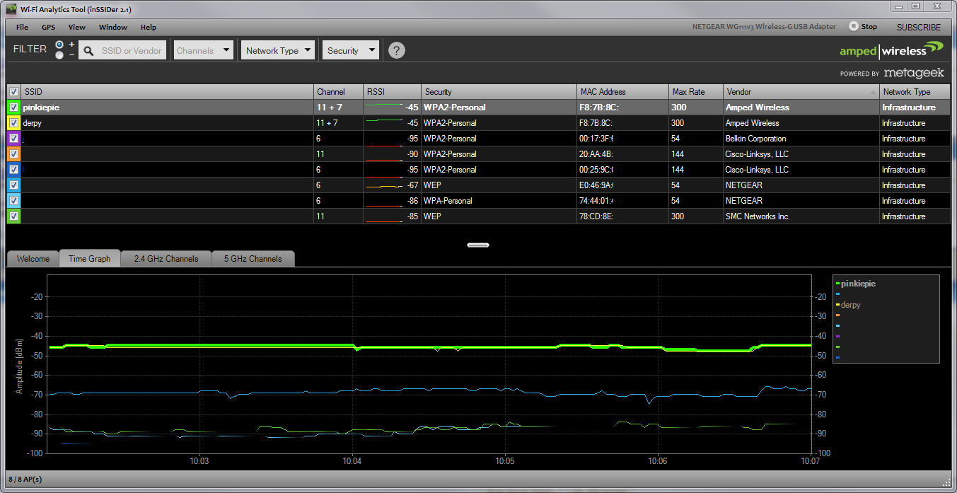

Here?s a few screenshots from Amped Wireless Wi-Fi Analytics software for windows:
This is on the desktop with a weak Netgear USB adapter that has a little issues?. It?s very old and has been beat up a lot:

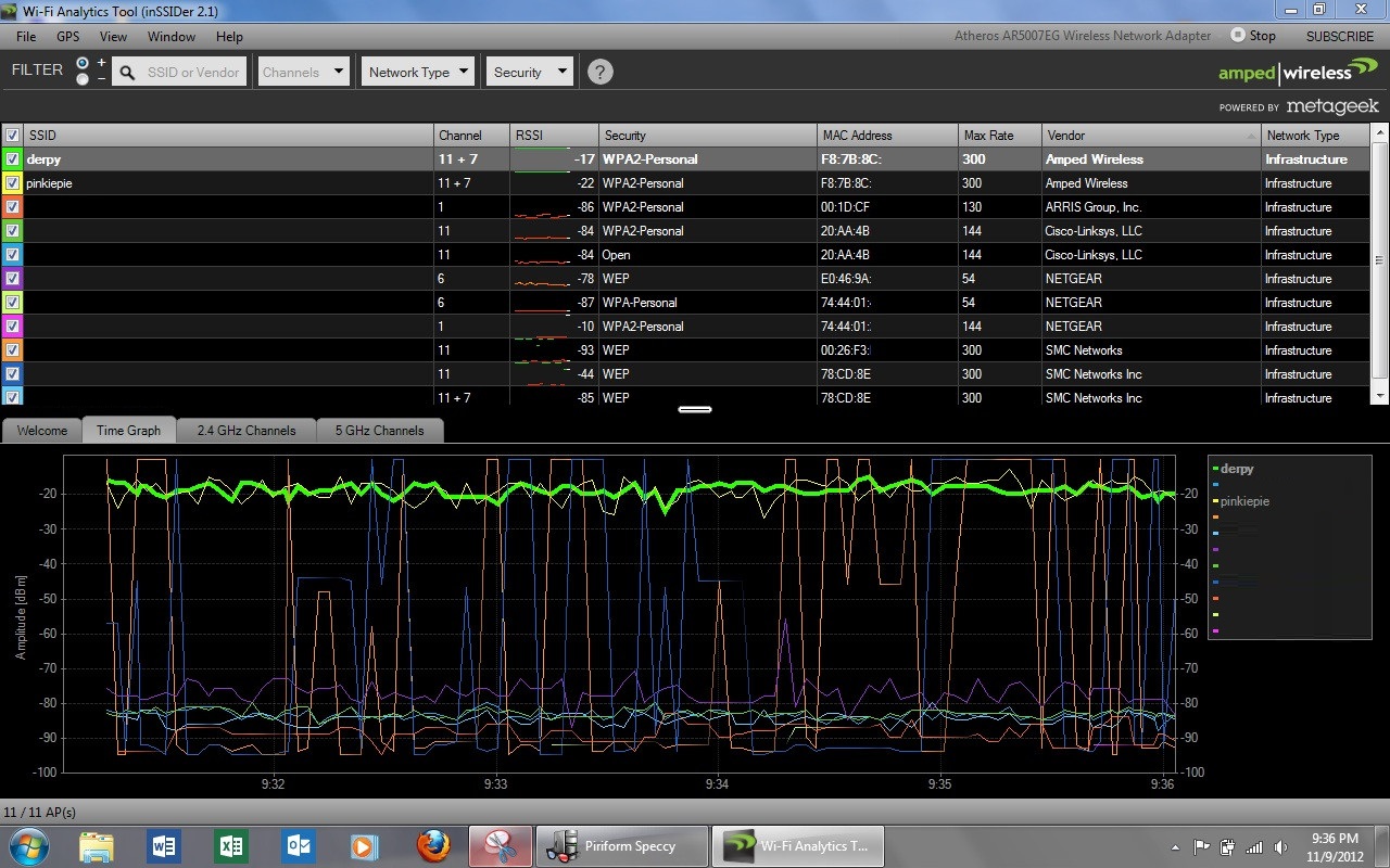

This is a funny result using the Acer laptop that has a built in Atheros adapter:
It?s funny how everyone else?s APs were flipping out while Amped Wireless was chill! LOL!

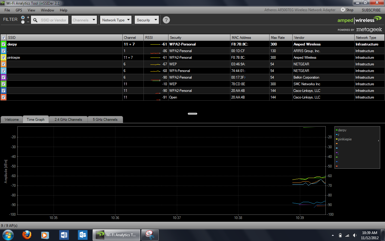

Here?s the readout from 45 ft away on the back porch, door closed, stormy weather:

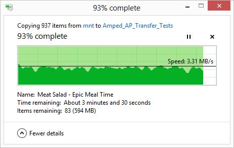

Transferring YouTube videos I downloaded?.. and look.. it?s EPIC MEAL TIME! LOL.
Please note: I am now running Windows Server 2012 and check out the new file transfer dialog! Nice!

? Somewhat slow USB transfer speed in comparison to direct USB connection
