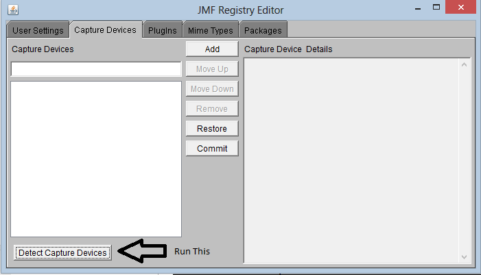

That means the Vector is empty and it couldn't find any devices. Did you use the installer version and run the JMF Registry scanner?
