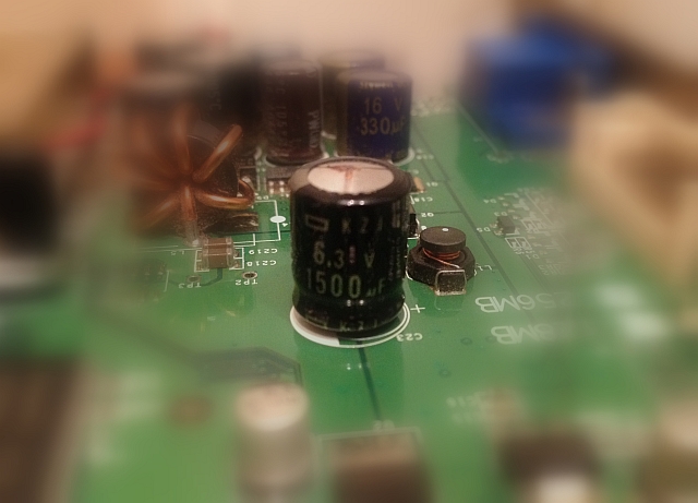

When PC is turned on, fans stay at max speed, no beep, no display

I wouldn't want to take a guess either, doing a search for "6.3v 1500uf" on that site brings up some caps but they don't look like the ones on your card, so not sure if the same with different design or completely different
Best waiting for someone who knows about electronics
EDIT - Ebay search brings some closer looking results

They look a closer match but again wouldn't want to guess, the wrong one could finish the card off completely
^ All that matters is the specs -- picofarads and voltage -- if they match exactly, it's OK.
Exact looks don't count.
There is going to be some variation between electronics manufacturers.
Check digikey, match up the farad rating and be sure that it's voltage rating is equal or higher and,if possible, look for a low ESR one. The spacing looks cramped so be sure to check the data sheet to be sure it'll fit in the existing footprint.
Also make sure you put them in the right way. There is a long leg and a short leg, the long leg is the positive side. Putting them in the wrong way will break them and possibly other components :)
You should look for a through hole electrolytic (so non ceramic) capacitor of the correct capacitance (measured in Fahrads). That's about all, doesn't really matter what it looks like :)

Which would you go for as a replacement? They're all radial, and all have a ?20% tolerance:
  1. ?0.33, 10x20 mm, 0.6 mm lead diameter, 5 mm lead pitch, 5000h lifetime, 1220 mA ripple current, 4 ?A leakage current
  2. ?0.40, 8x20 mm, 0.6 mm lead diameter, 3.5 mm lead pitch, 1220mA ripple current
  3. ?0.54, 10x20 mm, 0.6 mm lead diameter, 5 mm lead pitch, 3000h lifetime, 1220 mA ripple current, 3 ?A leakage current
  4. ?0.57, 12.5x15 mm, 0.6 mm lead diameter, 5 mm lead pitch, 5000h lifetime, 1205 mA ripple current, 3 ?A leakage current
  5. ?0.58, 10x20 mm, 0.6 mm lead diameter, 5 mm lead pitch, 5000h lifetime, 2180 mA ripple current
  6. ?0.60, 10x16 mm, 0.6 mm lead diameter, 5 mm lead pitch, 4000h lifetime, 2140 mA ripple current

Have you measured the existing cap?
measure the distance between the pins on the old cap, that is the lead pitch. It should be the same if you want the cap to fit. The other specs won't really matter for this case.
Pretty much this - this is true for all capacitors. As a matter of fact - the voltage rating doesn't really have a maximum. Although in my experience, the higher the voltage, the bigger the cap - so this does matter within reason :laugh:
just like inductors, the max voltage/amperage isn't exact. The component may work at 50v even though it's rated at 35v but the lifespan will suffer.

Cheap electrolytic caps tend to fail. If you know what you're doing, 30cents and 15 seconds, you're back on business.
