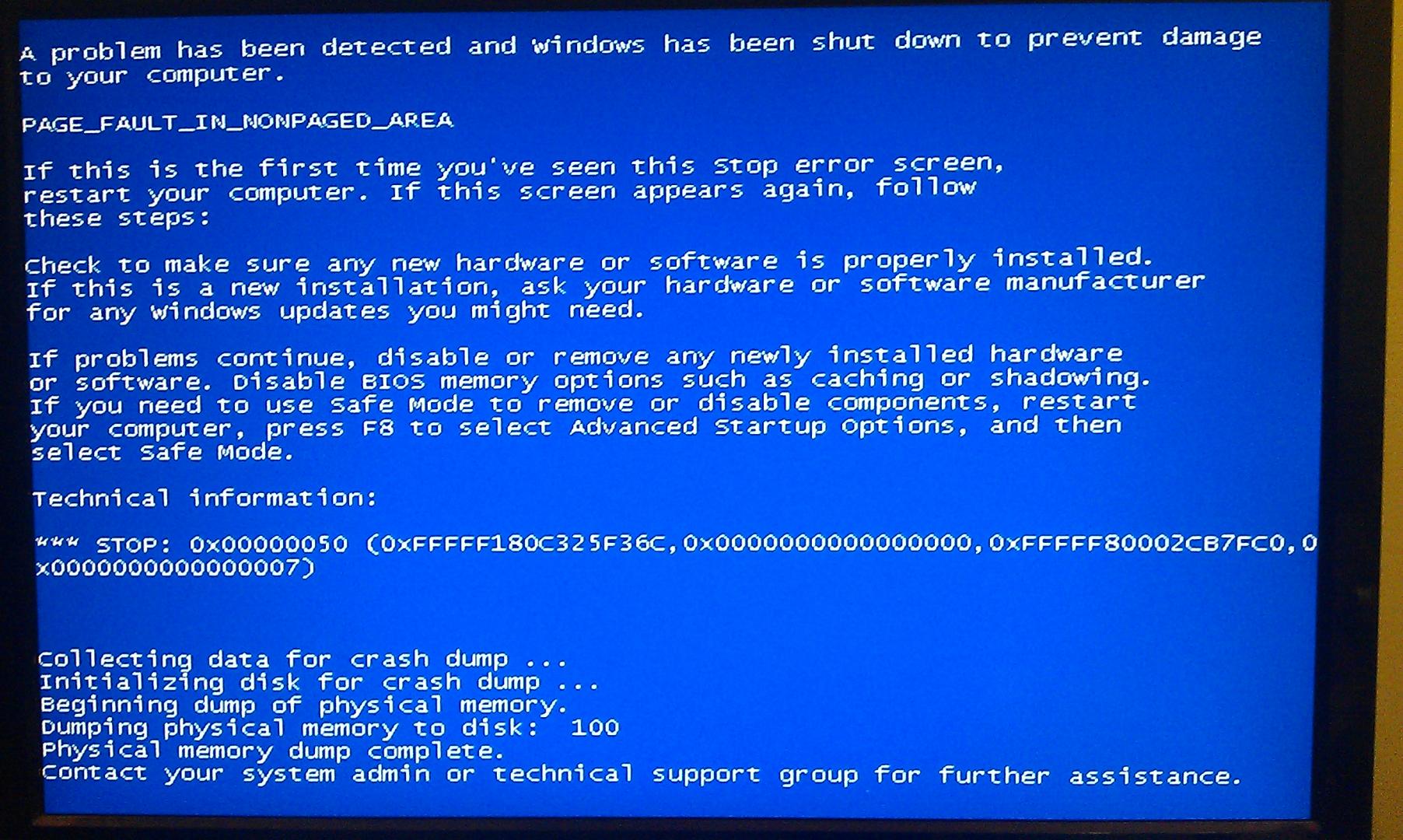

  On 07/01/2013 at 00:03, Redix said:
So, I was surprised when it reached 15% of the rendering process...but then it crashed again, so removing the OC doesn't seem to help. Also, the BSOD.
Stop 0?00000050: PAGE_FAULT_IN_NONPAGED_AREA ? This Windows stop error indicates that information that the operating system was looking for was not found in memory (ram). This occurs when the system looks for information in the ram that doesnt exist. This is usually caused by defective RAM (once again, including Ram on your motherboard, L2 cache and video card ram).
Get your ram testing on ;)
