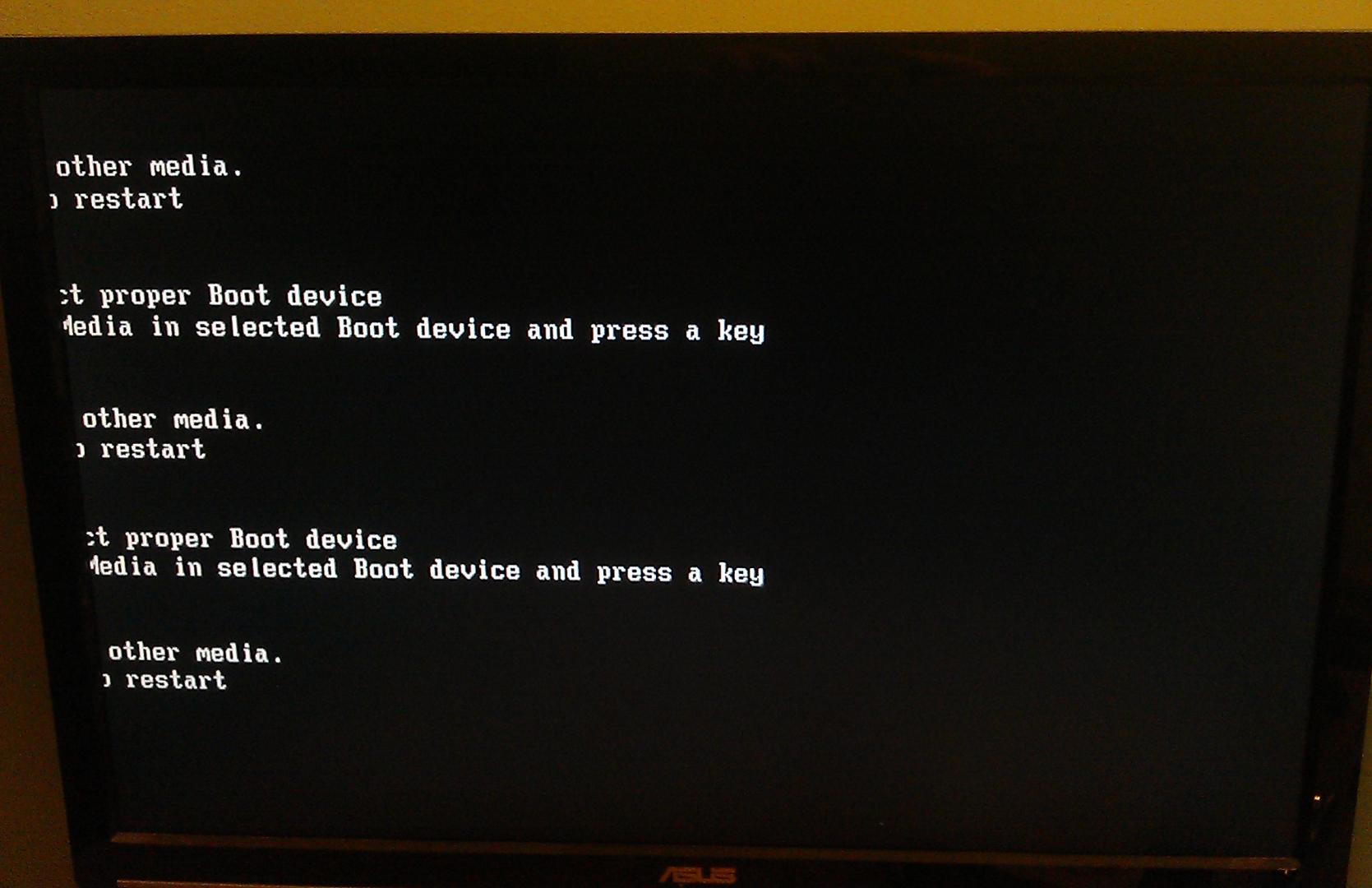

Errr waa?
Oh yea, that sentence seems overly complicated :) What I meant is, I wanted to test the RAM, but couldn't do it. I would have done it if I had CDs.
I'm not able to write in English anymore, it seems :)

I have a usb drive. I didn't know that that works. So I just put the .iso file on a usb drive and try to boot from it? Do I do it with both of my RAM sticks in, or do I test one by one?
you'll need to use a tool like this so the usb drive gets set as bootable http://www.isotousb.com/ or http://www.pendrivelinux.com/yumi-multiboot-usb-creator/ (memtest is near the bottom of the list in this program)
and you 'can' do the test with both in, either way, just be sure to reseat both of them before you boot to do the test (aka take the RAM sticks out and place them back in)
