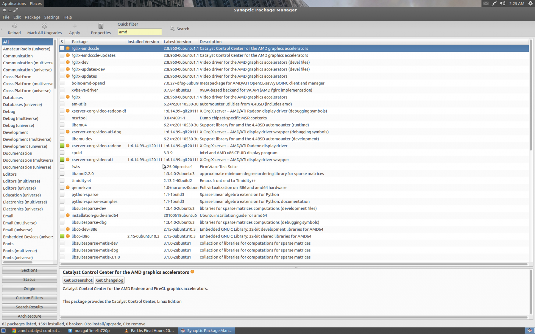

Apparently nothing was removed because the proprietary AMD graphics drivers were not installed in the first place. If you followed the remainder of the steps and you are still stuck in Unity 2D, you must have another problem. At this point, the contents of your /var/log/Xorg.0.log would probably help more than anything else. (Also, running sudo apt-get autoremove is a safe operation. It will remove any packages that were installed as dependencies to packages which are no longer installed.)
Based on that screenshot, you don't have the proprietary Radeon HD graphics drivers installed, only the open-source one. That's exactly what you want. However, if you're still stuck in Unity 2D, that's obviously not your problem. If you post your /var/log/Xorg.0.log I might be able to help you more, otherwise I don't have enough information to help you troubleshoot your problem.
