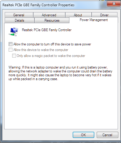

Only problem I had recently with my Ethernet was, kept waking up sleep.
That was easy to fix.
Maybe keep the settings as shown below.
