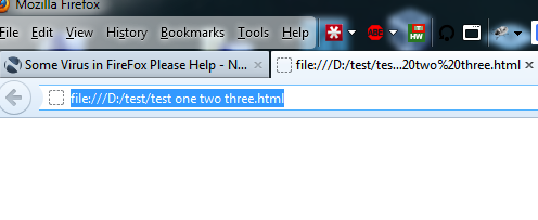

So when I open a html file in firefox it looks like this, only the 1 tab and address of the file I opened.. What does what your saying happen look like - post a screenshot!

So i opened a file "Funny 3 Words.htm" and this is i got :
in tab 1: file:///D:/Zzz/Funny
tab 2: http://www.****.com/Funny
tab 3: http://3/
tab 4:http://words.htm/
it starts searching for the each words of the file name and then sometimes redirects.
some times one tab redirects to some specific site ebook site or cam site.
