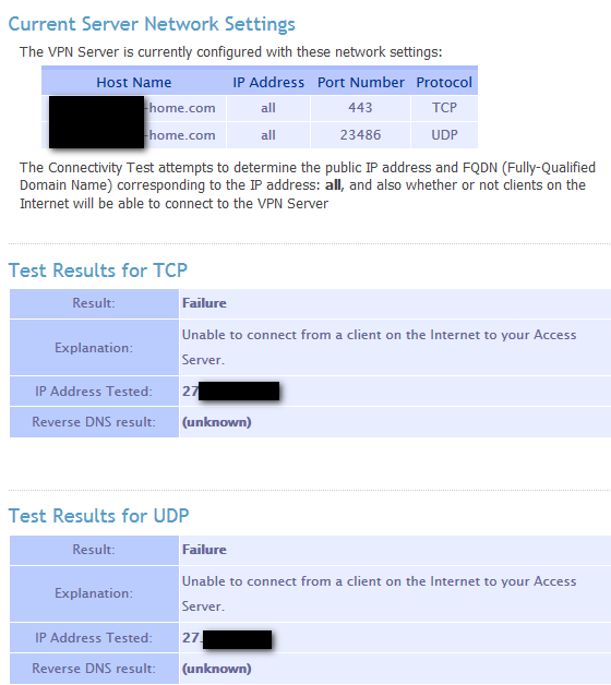

I want to be able to use my home internet connection while on the move for browsing as well as file access. I have downloaded and installed the VMWare appliance version of OpenVPN AS. Running it in VMWare Player on Windows Server 2012. I have created an account on DynDNS and got myself a domain to use with the VPN. Have also opened the required TCP and UDP ports on the built-in Windows Firewall and on my router.
However no matter what options I try, the client connectivity test ALWAYS fails! Really stuck here, don't know what to do!

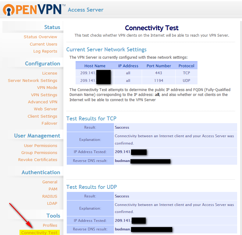

So your running this test?

See my edit - this is the test your trying, and what does it show for your ip, your public your internal?
What ports are you running on? You sure your not behind a double nat already, ports are not blocked by your ISP? See the above test - this is what your running right? I edited my last post.

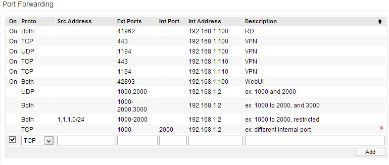

You can not forward a port to more than 1 address - you have .100 and .110 there
So your saying web gui at 42893 should be open and RD is what? Let me scan for those ports.. They are WAY high up and would not have tested for those most likely in default scan.

Those are old ones, I don't even use it any more. WebUI was a config panel for something, uTorrent I think. RD is Remote Desktop. I opened those years ago and actually forgot about them.
Oh ok, didn't know it has to be for one address only. So which one do I choose here? 100 is Server 2012, and 110 is OpenVPN.
I deleted that WebUI port a few minutes back as I realised I wasn't using it any more. Added back again. If you don't mind, can you check that port once more?

why would you forward 443 to your server, you need to forward it to the IP of your VM running openvpn

Your UDP is different that default, which is fine - but per what you sent me you were forwarding you are not forwarding that port.
Also you don't want your admin running on the same port as your service. So for example my admin runs on 943 and clients connect to 443 and 1194

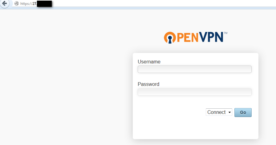

edit: Hmm shows your connected, but your test failed
5.5.8.2 708.81KB 6.20MB Sun Jul 14 19:30:06 2013
And did you set that vpn address.. Why would you have used 5.x.x.x ??
Oh ok, but I am able to access the Admin panel just fine! Also connected successfully from the other internet plan.
Weird, the test feature STILL shows failures! :(
