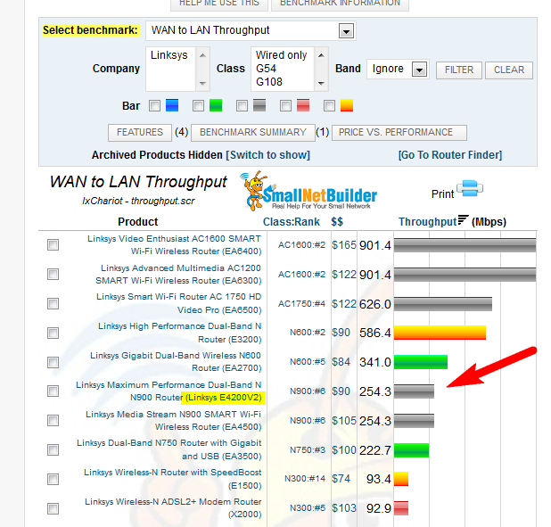

Yeah your going to need a new router that can handle that sort of bandwidth.. Clearly from this benchmark your e4200 can not
http://www.smallnetbuilder.com/lanwan/router-charts/
Sure if you have a spare PC around, or something you can run Virtual then you could run pfsense..  As long as your hardware your running pfsense can handle it then sure it can move 1GB between wan to lan.
You can then use your router as just an AP for wireless, where it will be fine.  But routing wan to lan with the tiny cpu and cheap hardware they put into most sohos for under $100 unlikely to be able to handle such bandwidth.  But there are quite a few listed that can do it from the benchmarks look at the link above to find your new router.
