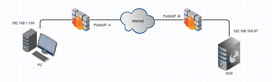

The IP address it is given you is just a network connection that is to be used as a tunnel to access the nas.. So for example your out on the internet with an IP 192.168.1.100 behind your nat router.. And you want to access your NAS that is also behind a nat router on say 192.168.100.87 (which is in your config you posted).. So you have this
Now you could port forward say http to your nat router to your nas and access it that way via http to your publicIP-B.. Or you could connect via vpn.. Your config there is for OpenVPN, So it is listening on port 9411 per your config. So you would forward udp 9411 to your NAS which again is in your config.
Then from the internet you would connect to your publicIP-B in the drawing above from your remote location using openvpn client. It would then create a tunnel network between you using

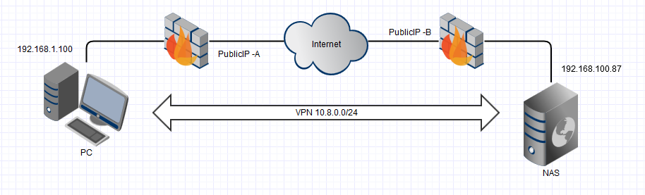

Anyhoo your connection would then be like this
And to connect to your NAS IP 192.168.100.87 your remote person would go through the VPN tunnel and directly access it. This still flows over the internet, but the details are hidden to you as the user, and from your machines point of view its just got a new network connection on 10.8 network - and it uses this connection to connect to the 192.168.100/24 network.
