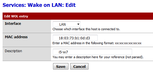

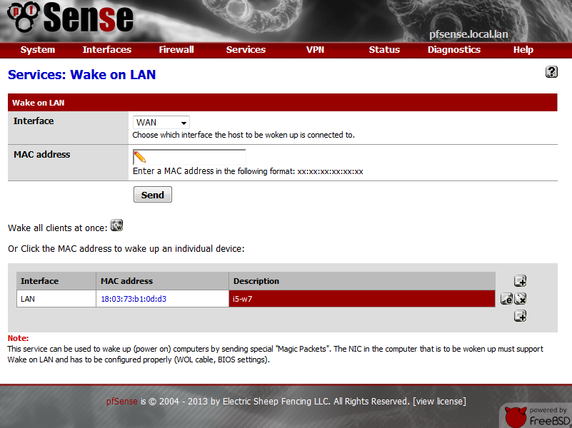

For example my router has ability to connect to it remotely and then send wol packets to boxes behind it

Just use a real router and use your AEBS as an AP ;)
LOL! Love your sense of humour! :) If i didn't have all these Apple wireless devices that just talk to "apple airport" chipset/ firmware flawlessly I would probably have grabbed some newer model openWRT asus router and dropped pfsense on it like yours has.  I was running gargoyle on a tp-link but it was dropping signal with my apple tv/ airport express (for streaming music to speakers) and ipads constantly. This AEBS is definitely what I needed in terms of a strong/ stable connection now to all my apple hardware (minus obvious PC). Range and everything was increased!  However Raspberry Pi, that's super low power consumption yeah?  I essentially didn't want to run my desktop 24/7 with dual SLI setup and overclocked components (that power draw).  But this R-Pi sounds like a good idea!

What does your gateway to your network have to do with what you use for wireless? If you have apple products that work best with wireless apple, then yeah use your AEBS for wireless.. But use whatever you want as your router, put openwrt on it, dd-wrt. Use a pc or vm and run pfsense, etc.
Your wireless does not, and to be honest shouldn't even be part of your gateway device. Just use your AEBS as wireless Accesspoint, not as your router off your network.
