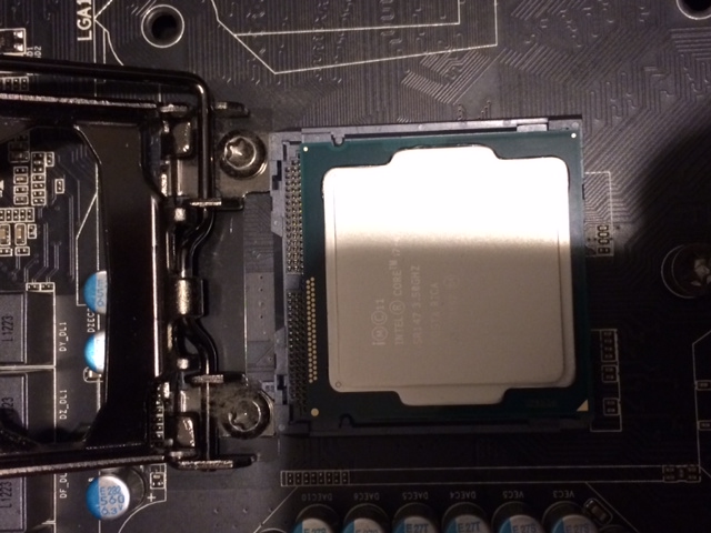

O o.... Do I need a new motherboard? I was under the impression that all Intel Core series processors were interchangeable.
See attached pic where my new intel core i7 4770k appears to be  a bit too small for the cpu housing on my Gigabyte GA-Z77X-UD3H.

Yes, you need a new motherboard. Your impression is inaccurate, while their are usually multiple processors that will work for any given socket, there are many different sockets used throughout the entire Intel Core series. Your current motherboard has an LGA1155 socket, which is suitable for a lot of Intel "Sandy Bridge" and "Ivy Bridge" based Intel Core series processors, while your new Intel Core i7 4770K CPU is "Haswell" based and requires a motherboard with an LGA1150 CPU socket.

There are 4 generation Intel Core? processors. Nehalem, Sandy Bridge, Ivy Bridge, and the latest Haswell. All 4 generation have their own variety of i3/i5 and i7 processors. The generation are not all interchangeable.
You have an Ivy Bridge motherboard. Ivy Bridge uses LGA 1155 and LGA 2011. The one you have is a Z77 that uses LGA 1155. The 4770K is an Haswell i7 processors, which needs a Z87 motherboard. Z87 is LGA 1150.

Sandy Bridge and Ivy Bridge (second-generation and third-generation) ARE interchangeable, and can use the same motherboards, despite their releases using different chipsets (Z68 and Z77 respectively).  Therefore, you CAN run Sandy Bridge in a Z77 motherboard, or Ivy Bridge in Z68 - however, I recommend Z77 chipsets for either generation (due to chipset improvements in Z77 compared to Z68) - both second-generation and third-generation CPUs use LGA1155.
LGA2011 is a variant of Sandy Bridge and Ivy Bridge (Sandy Bridge-E and Ivy Bridge-E).  Only one high-end chipset (X79) was released for LGA2011.
Haswell (LGA1150) is the successor to Ivy Bridge, and has the flagship Z87 chipset - it is not electrically compatible with Ivy Bridge OR Sandy Bridge, or with Z68/Z77.
