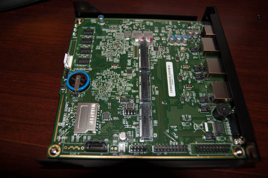

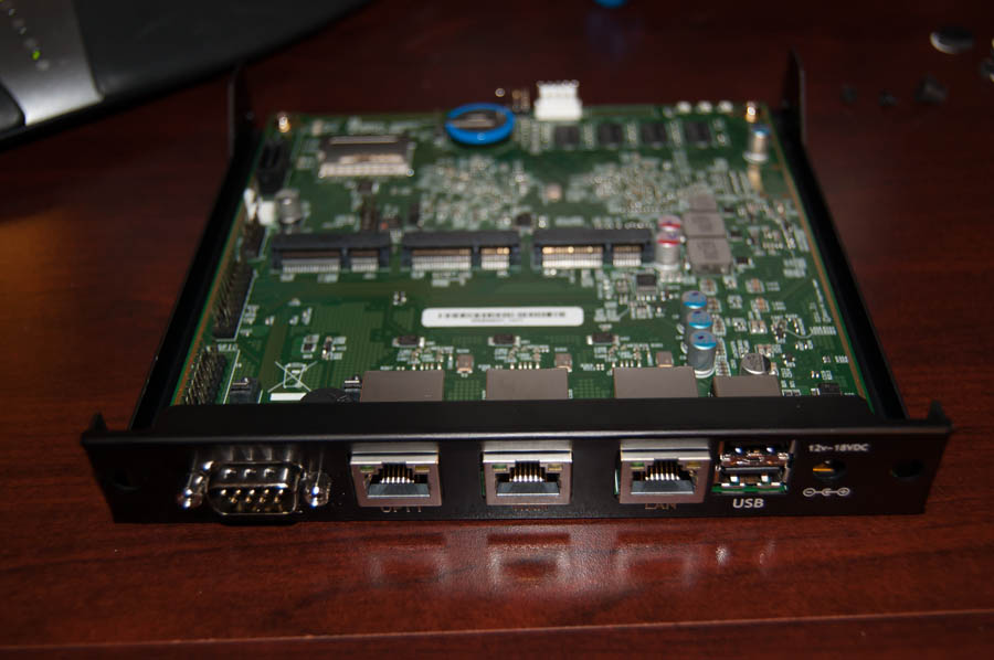

So far I'm liking this APU board. There was a very little bit of reconfiguring to get pfSense to boot (a whole one line needed changed in the kernel config) I'll post about that later. I've been running the thing with stress testing software for a while now, yeah it gets warm, but not hot, you notice it because of the way the heat sink is configured.
pfSense seems snappy, don't really notice any difference in routing speed form it and my demo unit I originally tested pfSense on (an intel 920 i7 system with 6GB of RAM and dual intel NIC's). I'm sure when I start pushing 1Gbps constant it might struggle a little bit, but as of now it's not going past 20% CPU usage so I don't think the review the IPFire site had on this board is accurate to the current BIOS firmware and the current drivers that pfSense uses.
The most annoying thing though is the boards serial console is at 115200 baud, while pfSense by default has a 9600 baud console... so had to keep switching baud rates between boot and initial load.
There is a newer BIOS then the one I have now, but haven't upgraded it yet.. I'm on the december 2013 BIOS, the current on is April 2014. I'll have to try it later and see how it goes.
budman, anything specific you think I should try out or anything you'd like to see?
yesterday I threw in an Intel 30GB mSATA card on the APU board, reinstalled pfSense with the USB Memstick installer and it is running DRASTICALLY faster... didn't think it would but it is..
It seems to be maxing out at 820 Mbit / sec with peaks to 840Mbit/s routing wise with at 78% CPU load
did notice that when using the SD card as a storage medium for the OS during load the CPU usage spikes, it uses a USB interface on board to talk to the SD card and seems to be offloading a lot of it's work to the CPU... going to the mSATA card with a on card controller made that CPU load virtually nill during load
