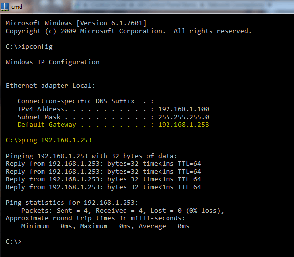

I would use the wired one.  Disable your wireless and only use the wired, if you get issues with limited access on the connection - this quite often is when you lose your dhcp lease, it doesn't renew and you get a APIPA address 169.254.x.x
What I would do next time the problem happens, is look from a cmd line ipconfig /all and what does it show you for your IP, if it starts with 169.254.x.x points to your dhcp lease expiring and not getting a new one.  Try ipconfig /release, and then ipconfig /renew to get a new one.  Or just disable/enable your interface.
