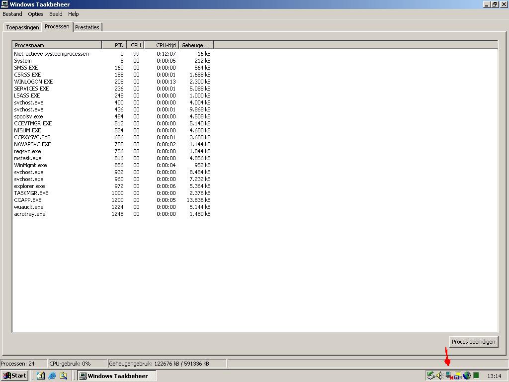

Is this 2k pro (desktop) or Server? Could be a service that's loading up at startup. If you could post a screenie of what's running in the Task Manager, that'd be great.

As promised the screenshot. I also marked -with a red arrow- the network icon (not connected to a network).

what's ccapp.exe or whatever?
