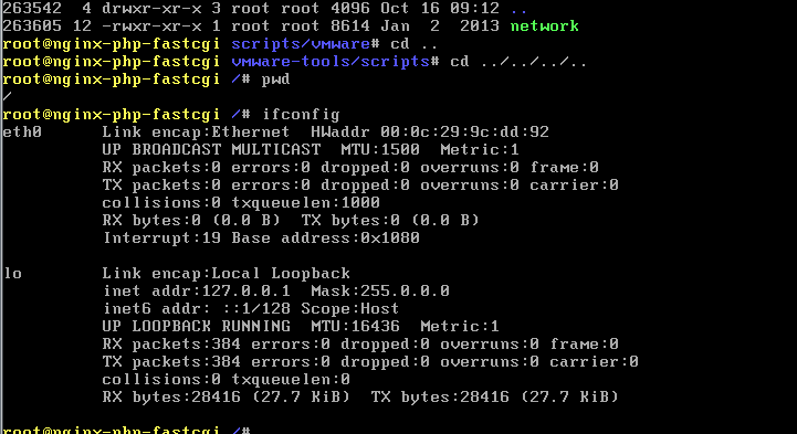

I would like ask, since I'm pretty unfamiliar with the VMware Player 5. I just injected a virtual machine (.vmdk), with Debian 7 & NGINX, PHP and fastCGI running on it. I want to test out some websites, etc on this virtual server. Currently I have it bridged to the host, and my question is how can I access pages served by this virtual web server on the host (Win7)?
I think the main problem is that I don't know VMware works. Is there any settings, config which I missed?
Thanks in advance.
PS: at the moment of screenshot ETH was turned of, due to I know know, NAT or bridges is the proper solution.
https://www.neowin.net/forum/topic/1202339-vmware-player-5-debian-7-nginx/
If it was bridged to your host then your VM network interface should have an IP on your hosts network.. From what you show there is no IP address on the VMs eth0 - so no your not going to be able to access anything on that vm over a network.

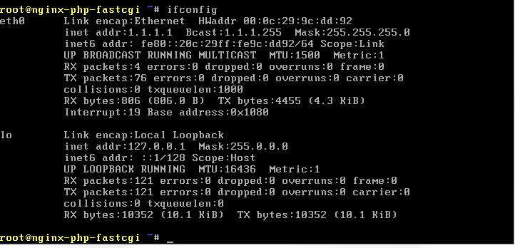

So, I started the host only connection, but, since obviously 192.168.xxx.yyy that was choosen by default wasn't really the right IP since there is actually a PC in my host network that runs with that. So now I tried to choose and IP address that is most likely not in my network and is fairly extreme: 1.1.1.1
Can I access this VM address in a browser, without interrupting my real networks connectivity?

192.168.x.x not being the right IP is not obvious at all, that depends on your network's mask.
Your network is probably 192.168.0.x or 192.168.1.x with a 255.255.255.0 netmask, while the VM should have a 192.168.122.x IP (or similar).
Check you host's network configuration, you should have at least one virtual adapter there (likely vmnet0) with an assigned IP address. If you configure your VM's network adapter as NAT or host-only it should have an IP address in the same network as the host's vmnetx.
If VMware is assigning IPs in the range of your actual network to the virtual adapters then something's wrong with your VMware Player install.
