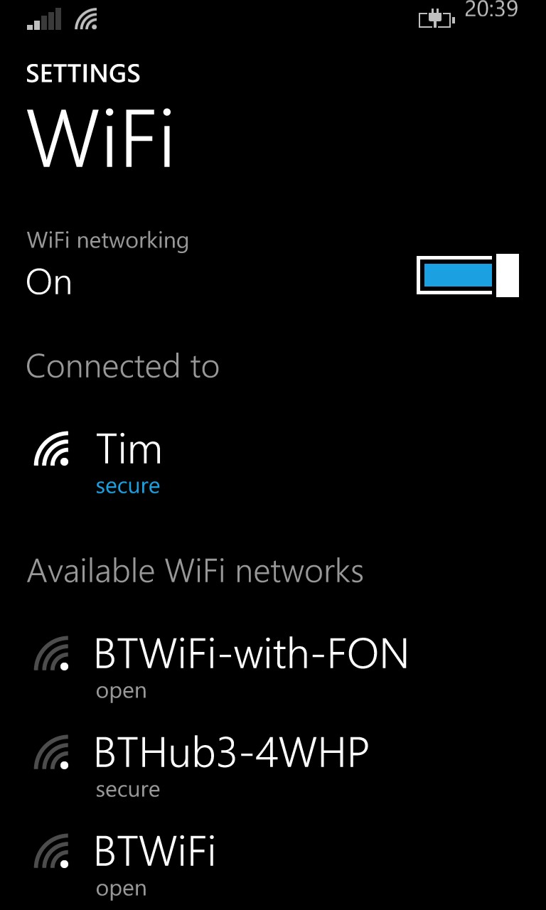

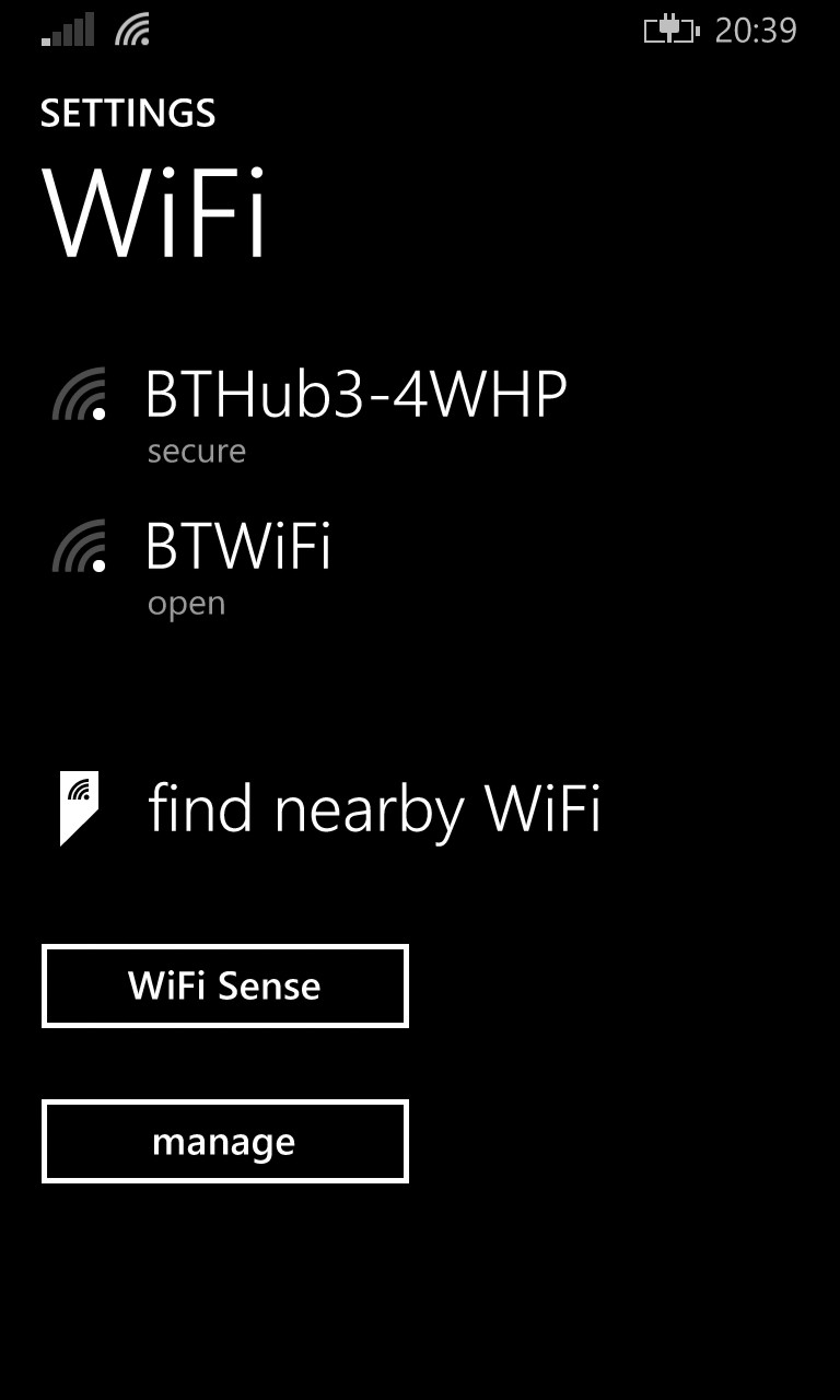

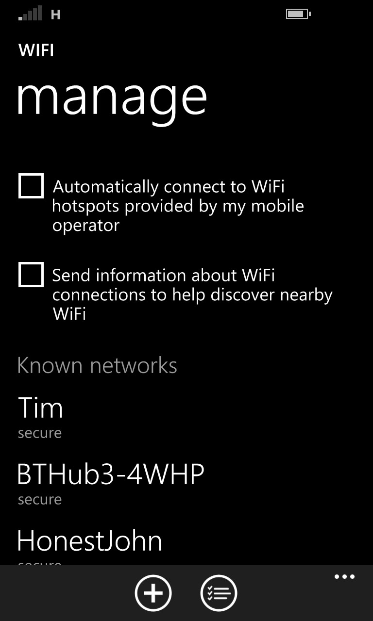

I think they removed the setting in 8.1.  At least on my Nokia Icon it's not there anymore.
Settings -> Wifi -> Advanced button. There is a checkbox to keep wifi on when screen times out. (I have ATIV SE, 8.0 GDR3...might be slightly different in 8.1)
No advanced button here - like I said, this function has been removed.
post-276090-0-63946400-1400096572.jpgpost-276090-0-83655300-1400096582.jpgpost-276090-0-90488300-1400096824.jpg

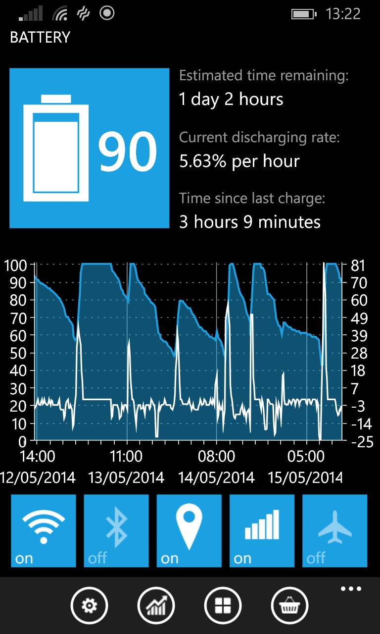

Since the update last night, i've noticed significant gains in battery life. See attached screenshot from Battery, a third party app which I've been using to monitor battery life for over a year.
Yeah the Battery app is telling me i should get about 1 day and 4 hours of battery life on my phone now. I dont have any fear that it could actually do it. I usually unplug it at 7am and do not plug it in again until 2300 and usually have around 60% left on my battery.
That's how I was doing before updating to 8.1
what I've noticed has changed specifically however is the period overnight after last night's update - compare last night to the night before!
