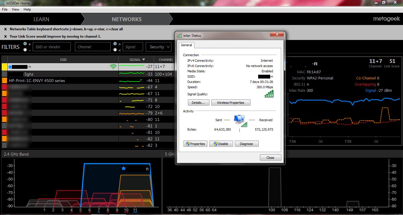

edit:  Ok here is from my wifes laptop
You can see windows reports 300, and signal strength and using 11+7 (40 mhz)  And what other network in the area might be interfering..  I have to track down this HP 1C thing - I don't have any HP printers.. But that signal looks so strong seems to be in the house??
edit2:  Ok found that HP printer, it was my Cannon HF R40 camera, it was plugged into my computer..  Wasn't even on..  Pulled the batter off and wireless went away so clearly that - going to have to look into why it says its a freaking printer, etc..  There is a new firmware update, might try that..
But anyway -- If you could fire up insidder or something like it we could see what is going on in your network..  Feel free to hide your SSID or others in your area etc..   We are just interested in see the strengths and your connection speed, etc..

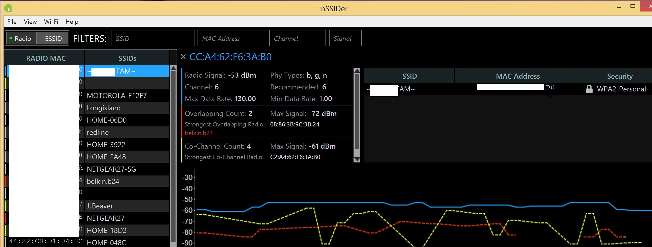

okay i made a post and it got deleted but i lost it...so here goes..
im not sure what it means to be 20hz or 40hz however ive attached the screen shots now...

Ok for one your signal is kind of low -53.  Second you have others all over your channel - 4 others on the SAME as you..And your only using 20mhz.
802.11n brought the ability to combine channels so vs using just 20mhz you could use 40mhz..  AC when all said and done will be able to do 160mhz..
Seems your very crowded so going to 40 mhz channels might not help - you need to look in your router configuration if supported or not..  I would look to see if 6 is the best channel..  Look on your graph and see what other channels are in play.
See the bottom graph on the left in my pic -- see all the other wireless networks..  I might be better off moving to 11, the strength of those are smaller.  I did get rid of that strong one on mine that was my camera.  So look at that graph and see if maybe 1 or 11 is better.  Your on 6 which is default and normally everyone sits there because they don't know enough to change it ;)
Also you seem to be running yours in b/g/n mode - do you have b or g devices?  If not change it to N only - not running in pure N will be a hit.  With N it is possible to use 400ns guard vs 800ns -- this can be a bandwidth increase of 10% or so if you can use it.  Allowing for b/g for sure will mean your not.
I would try changing your channel to 1 or 11, I would see if your router supports 40 vs 20 for your channel size and would put it into N only mode - unless you have b/g devices?  I find it hard to believe any B - so change to g/n if that is the case.
If your still not hitting your internet speed.  New AP could help yes - do your devices support 5ghz vs 2.4?  You might want to look to a dual band AP - this supports 2.4 and 5.  Notice on the graph on bottom right of my pic, this is 5ghz notice how like no other wireless networks there..  Looking up the specs of your laptop cards http://ark.intel.com/products/75440/Intel-Dual-Band-Wireless-N-7260
