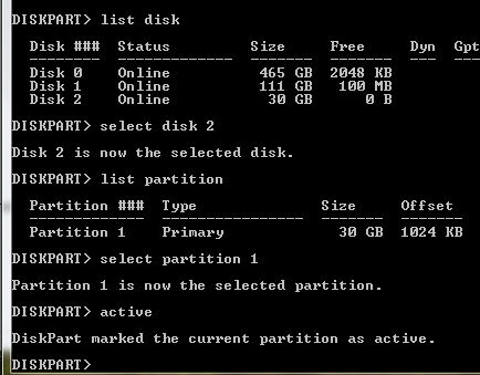

You also need to run DISKPART and mark the partition on the USB stick as active. Then you need to go to a command prompt, change into the BOOT directory on the Windows 7 installation media and run BOOTSECT /NT60 X: where X is the drive letter of your usb stick
DISKPART
Click Start, type in CMD and press <enter>
Type in DISKPART and press <enter>
Type in LIST DISK and press <enter>
Type in SELECT DISK x where x is the disk number from the previous step and press <enter>
Type in SELECT PARTITION 1 and press <enter>
Type in ACTIVE and press <enter>
Type in EXIT and press <enter>
BOOTSECT
From the command prompt, type in X: where x is the drive letter of your Windows 7 installation media and press <enter>
Type in CD BOOT  and press <enter>
Type in BOOTSECT /NT60 X: where x is the drive letter of your USB stick and press <enter>
That should do it...
Type EXIT <enter> at that screen.
Then navigate to the CD drive / mounted ISO you copied the installation files from. So if in Windows Explorer it's on D: drive, then type in D: <enter> at the command prompt, then CD\BOOT <enter>, then BOOTSECT /NT60 X: <enter> where X is the drive letter of your USB stick, which you should also be able to see from Windows Explorer.

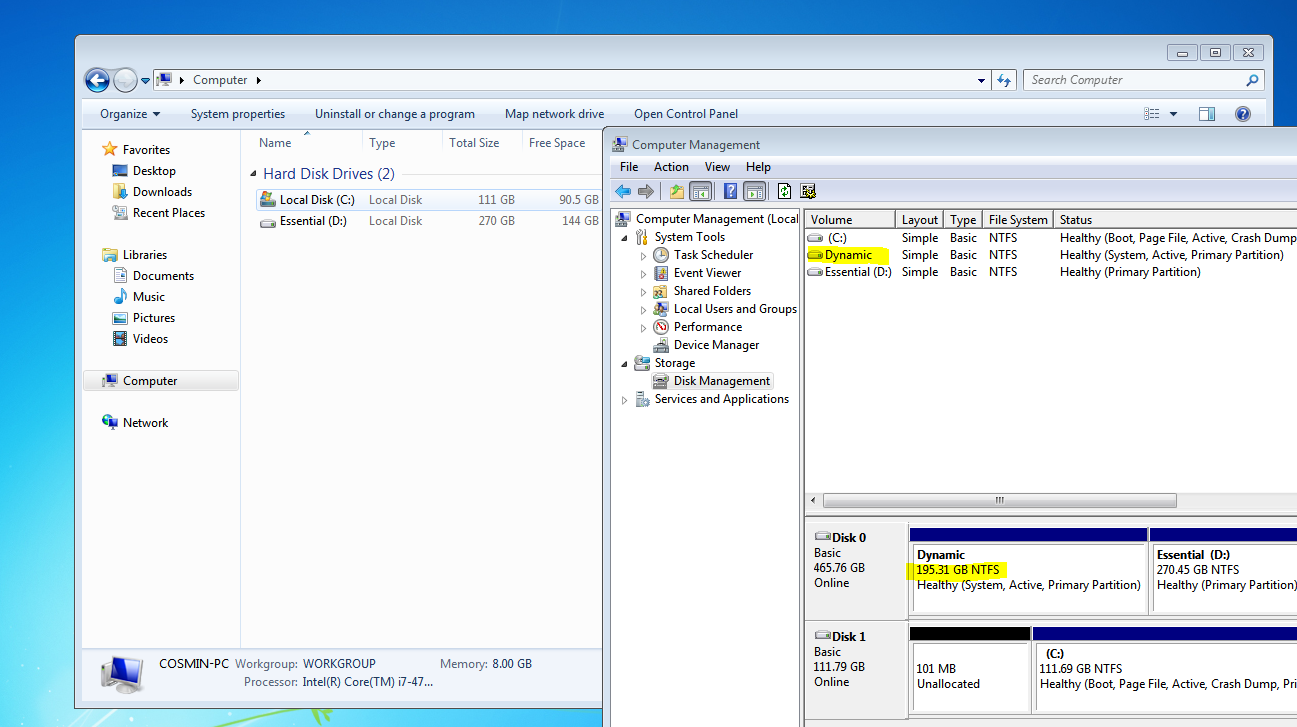

Finally succeed.. but I realize that one partition from my hdd seems to be hidden.. how do I get it back ?
Thanks for all your efforts!
Can you right click the one not showing up and give it a drive letter?
Yes.. that did the trick but one more wierd thing happends..
If I choose as fist boot device the SSD with C: drive it gives me that bootmgr missing error.. If I let the HDD as first boot or even the .. usb stick it goes well..so it starts with o.s. from ssd even it's not set as first boot device.. now this gives me a bit more worry than I've expected..In rest..all seems ok now but.. any suggestion is welcome.
Ah I guess the deal here is that... um, you had OS on HDD before? So therefore it was first one even before, therefore it installed bootloader to HDD instead of SSD. Sort of missing the point of SSD in that case, since at bootup it still has to look HDD for bootloader.
Safer would have been to disconnect HDD for installation.
No.. it hasn't been installed on hdd before..it was on ssd all time. What can be done now? Probably if I'll disconnect hdd now it will give me that error again :D.. The wierd thing is that on first install all was pretty fine from A to .. Z.
Not sure you can easily move bootloader from HDD to SSD. Not sure, might be some way with EasyBCD, but if you're not too far in configuring new installation, I'd suggest to reinstall.
